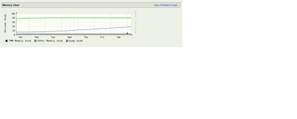

Abnormal Swap Memory usage due to umem process usage
BIG-IP 10250 BIG-IP v13.0.0 (Build 0.0.1645)
There is an abnormal swap memory usage regarding umem process in a BIG-IP which is strange and I need to know the root cause , once i tried to "bigstart restart tmm" and it was working fine but after 3-4 days , again the swap memory starts to increase and the process I found is umem which occupies a large proportional of swap memory , I need to know how to handle this issue, here is some more snapshot from the BIG-IP :

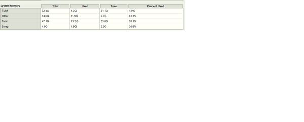

and here is some detail
and here is umem process detail
