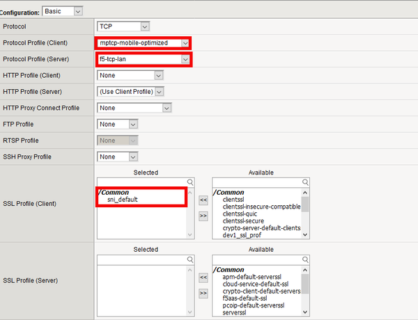

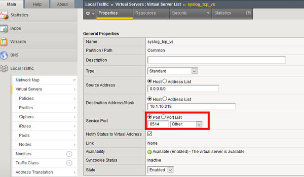

Make our TLS Syslog virtual server on the BIG-IP, this is normally defined on port 6514.
Next, we make our selection. Will you be processing TCP or UDP messages to your backend?
