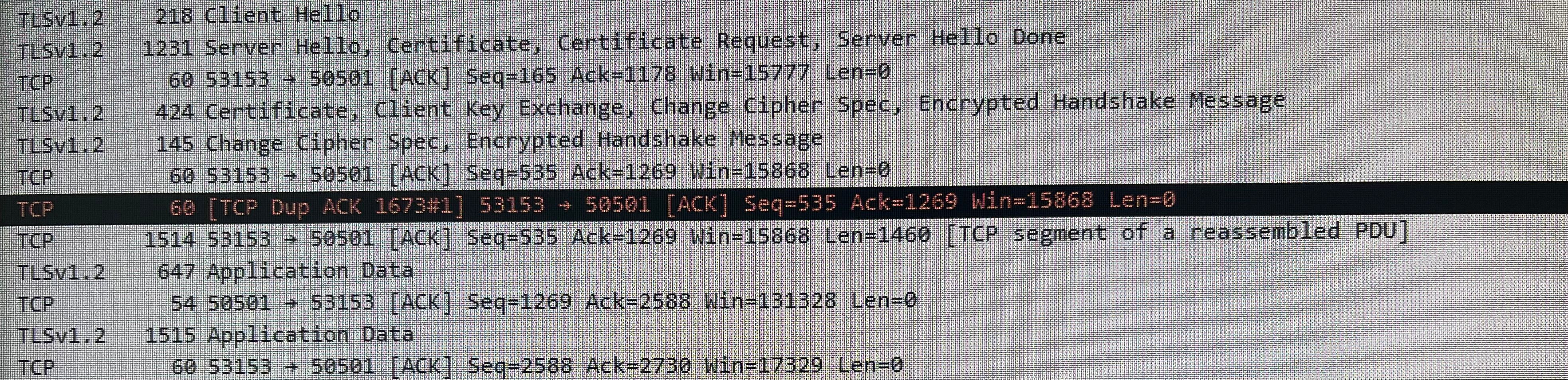

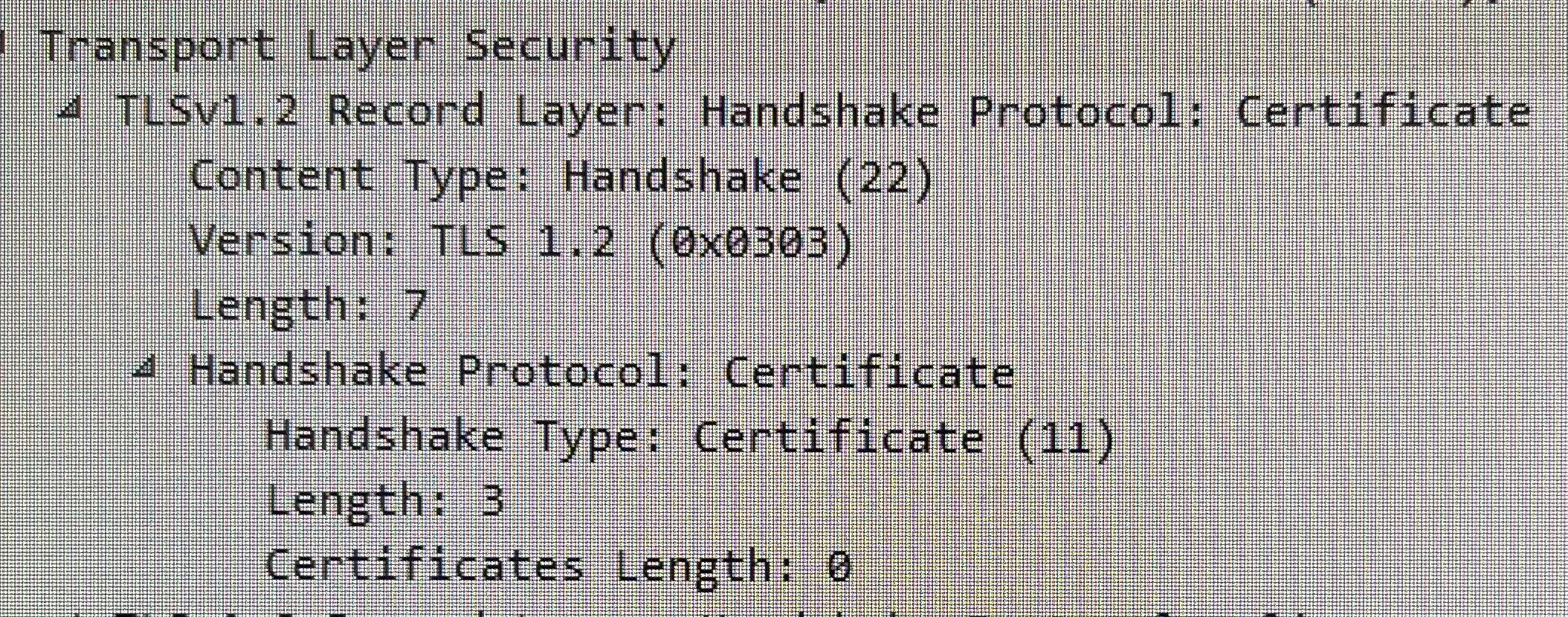

2 Way SSL not working as client certificate length is 0
I have already config about Client certificate is request, But not working. Can anyone please help me or guide me.
8 Replies
from the above pictures, it seems that the client does not present a client certificate.
