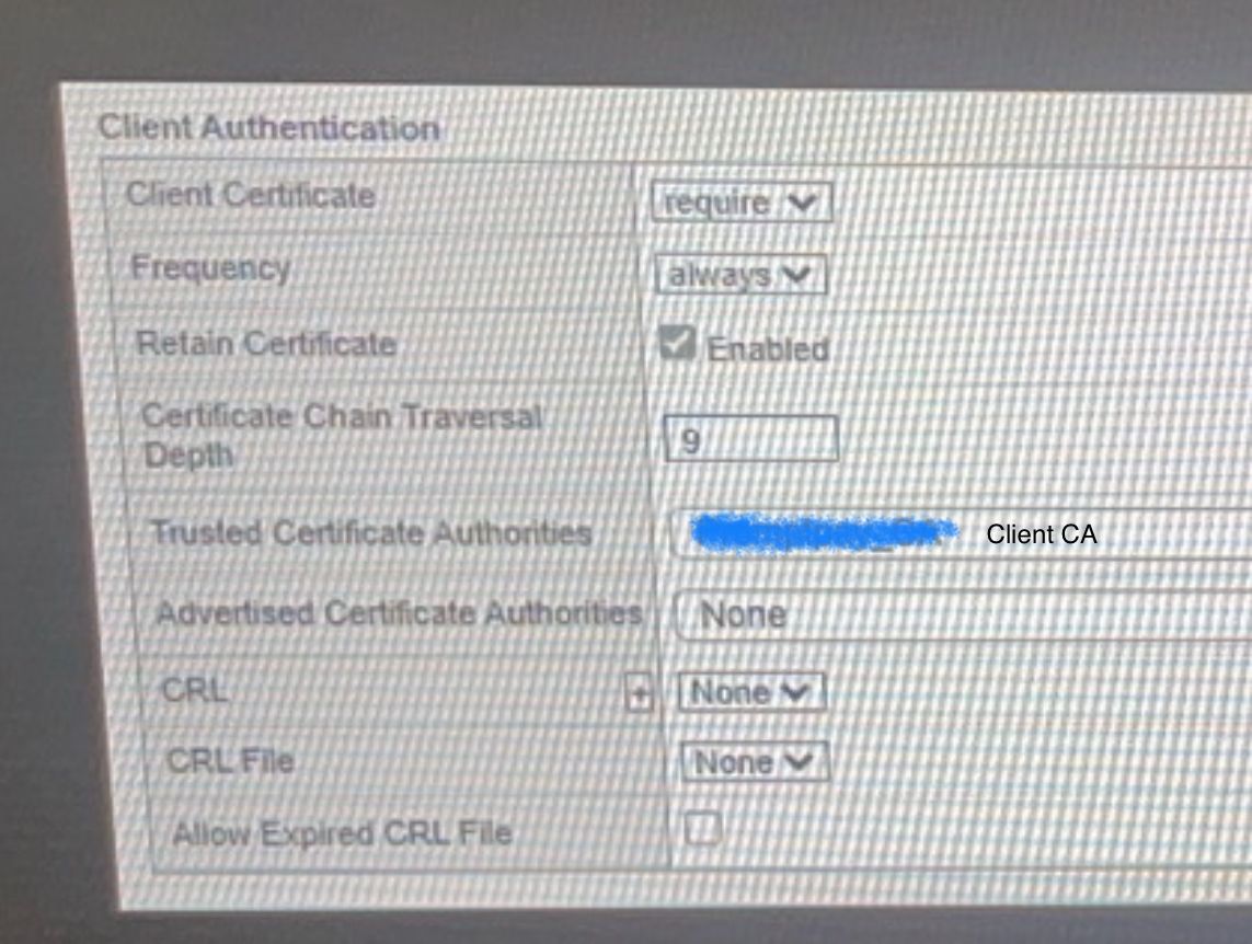

Yes, I still need encrypted comunication between f5 <> real server and I testing traffic "directly" with F5 IP.
How to config on F5 for send client certificate to destination server?
This my config
Thanks

There's the option to do it with a HTTP header: https://my.f5.com/manage/s/article/K95338243
Or you can enable ProxySSL on both your client- and server- SSL profiles: https://my.f5.com/manage/s/article/K13385
