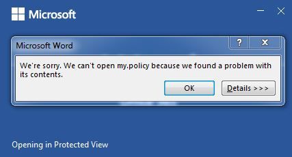

I've imported the user-certificate for user test1 into the browser and created this policy:
