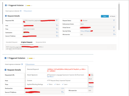

Hello Everyone I hope Youre well!!! I have a policy created in WAF, and I have this request URL; however, it needs to be valid, yet the WAF blocks it and flags it as a level 3 triggered violation. How can I exempt this URL so that the WAF accepts it and doesn’t block it? Thanks151Views0likes4CommentsAdvanced WAF v16.0 - Declarative API
