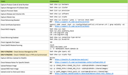

Problem this snippet solves: Next article describes an upgrade procedure to perform only using CLI commands. The idea is not to replace an official procedure, but to give a different approach for those guys who love using CLI and they want to execute an upgrade only using commands (without GUI access). The procedure is separated in 4 sections: Data Collection & Planning - for executing some days before the upgrade. Pre-Upgrade Tasks - for executing just before the upgrade (applies to all devices in the cluster). Upgrade Tasks - Only applies for one device in the cluster for each time (normally standby device). Post-Upgrade Tasks - for executing just after the upgrade (applies to all devices in the cluster). This procedure is valid for most of the BIP-IP set-ups: Standalone & clusters vCMP Host & vCMP Guests GTM/DNS Synchronization Groups Everything that helps to fix mistakes is great, so your comments are welcome. OFFICIAL REFERENCES: Release Notes - https://support.f5.com/csp/knowledge-center/software/BIG-IP General Upgrade Procedure - https://support.f5.com/csp/article/K84554955 GTM/DNS Upgrades - https://support.f5.com/csp/article/K11661449 VCMP Host Upgrades - https://support.f5.com/csp/article/K15930#p17 HW Life-Cycle - https://support.f5.com/csp/article/K4309 SW Life-Cycle - https://support.f5.com/csp/article/K5903 HW-SW Compatibility - https://support.f5.com/csp/article/K9476 Upgrade Path - https://support.f5.com/csp/article/K13845 How to use this snippet: >> DATA COLLECTION & PLANNING (ALL CLUSTER DEVICES) >> PRE-UPGRADE TASKS (ALL CLUSTER DEVICES) >> UPGRADE TASKS (ONE DEVICE AT TIME) >> POST-UPGRADE TASKS (ALL CLUSTER DEVICES) Code : ###################################################### ## DATA COLLECTION & PLANNING (ALL CLUSTER DEVICES) ## ###################################################### ## Capture Product Code & Serial Number tmsh show sys hardware ## Capture Management IP & Blade State tmsh show sys cluster ## Capture Provision State tmsh list sys provision ## Capture Release and Volume Info tmsh show sys software ## Capture Master-key tmsh show sys crypto ## Check Relicensing Needed tmsh show sys license | grep -i 'service check date' REF - https://support.f5.com/csp/article/K7727 ## Check Certificate Expiration openssl x509 -noout -text -in /config/httpd/conf/ssl.crt/server.crt | grep Validity -A2 REF - https://support.f5.com/csp/article/K6353 ## Check RAID Integrity tmsh show sys raid tmsh run util platform_check cat /var/log/user.log cat /var/log/kern.log ## Check Mirroring Enabled tmsh show sys connection type mirror tmsh show sys ha-mirror ## Check Upgrade Disk Space (At least 20Gb) vgs ## Check ZebOS Module Running vtysh zebos/rdX/ZebOS.conf >> 'X' REPRESENTS ROUTE DOMAIN ID ## ONLY GTM/DNS - Check Devices Managed by GTM tmsh show gtm iquery all ## ONLY GTM/DNS - Check if DNSSEC keys in FIPS are Synchronized tmsh show sys crypto fips ## Capture QKView (Upload to iHealth) qkview REF - https://ihealth.f5.com/qkview-analyzer/ ## Check Release Notes For Specific Details REF - https://support.f5.com/csp/knowledge-center/software/BIG-IP ## Upload Release Image scp -p / @ :/shared/images/ ## Upload MD5 Hash Image scp -p / @ :/shared/images/ ## Upload Script to Check Pool Status scp -p /Check_Pool_Status.sh @ :/shared/tmp/ REF - https://github.com/DariuSGB/F5_Bash/blob/master/Check_Pool_Status.sh ############################################# ## PRE-UPGRADE TASKS (ALL CLUSTER DEVICES) ## ############################################# ## Disable Virtual Server Mirroring REF - https://support.f5.com/csp/article/K13478 ## Disable Config Auto-Sync (if enabled) tmsh modify cm device-group auto-sync disabled ## ONLY GTM/DNS - Disable GSLB/ZoneRunner Synchronization tmsh modify gtm global-settings general { synchronization no synchronize-zone-files no auto-discovery no } ## Save Running Config tmsh save sys config ## Check HA Cluster Synchronization tmsh show cm sync-status tmsh run cm config-sync to-group ## Check Release Image Integrity cd /shared/images/ md5sum -c ## Create Initial UCS (Backup) tmsh save sys ucs /shared/tmp/$(date '+%Y%m%d')_initial.ucs ## Capture Initial Config tmsh save sys config file /shared/tmp/$(date '+%Y%m%d')_initial.scf no-passphrase ## Capture Initial Pool Status /shared/tmp/Check_Pool_Status.sh > /shared/tmp/$(date '+%Y%m%d')_initial_pools_output.txt ## Check No Upgrade Process Running tmsh show sys software status ## OPTIONAL - Get More Free Disk Space (At least 20Gb) tmsh delete sys software volume vgs ######################################## ## UPGRADE TASKS (ONE DEVICE AT TIME) ## ######################################## ## Restart AOM to Prevent Licensing Problems (iSeries) ipmiutil reset -k REF - https://support.f5.com/csp/article/K00415052 ## ONLY VCMP HOST - Check That All Guests Are In Standby tmsh show vcmp guest >> ACCESS INDIVIDUALLY TO EACH GUEST tmsh show cm sync-status ## ONLY VCMP HOST - Deprovision All Guests (Configured) tmsh show vcmp guest >> EXECUTE FOR EACH GUEST tmsh modify vcmp guest state configured tmsh save sys config ## Re-licensing Device >> BIG-IP WITH INTERNET ACCESS tmsh install sys license registration-key add-on-keys { } REF - https://support.f5.com/csp/article/K15055 >> BIG-IP WITHOUT INTERNET ACCESS cp /config/bigip.license /config/bigip.license.backup get_dossier -b -a ** ACCESS LICENSE ACTIVATION https://activate.f5.com/license/dossier.jsp ** PASTE LICENSE FILE (ENTER 'CTRL+D' AFTER PASTING) cat > /config/bigip.license reloadlic REF - https://support.f5.com/csp/article/K2595 ## Force Offline Mode tmsh run sys failover offline ## Verify Configuration Integrity tmsh load sys config verify ## Install Image tmsh install sys software image create-volume volume ## Check Installation State tmsh show sys software status cat /var/log/liveinstall.log ## OPTIONAL - Copy Configuration To New Volume ## (Only if you have made changes since installation) clsh --slot=X,Y cpcfg >> FROM VIPRION cpcfg >> FROM NOT VIPRION ## Boot On New Volume tmsh reboot volume ## ONLY VCMP GUEST - Check Boot Up Status >> FROM VCMP HOST vconsole ## Check Logs (LTM, APM, ASM,...) REF - https://support.f5.com/csp/article/K16197 ## Capture Final Config tmsh save sys config file /shared/tmp/$(date '+%Y%m%d')_final.scf no-passphrase ## Compare Initial-Final Config tmsh show sys config-diff /shared/tmp/$(date '+%Y%m%d')_initial.scf /shared/tmp/$(date '+%Y%m%d')_final.scf | egrep -e "\s{3}\|\s{3}" -e "[<]$" -e "^\s*[>]" ## Disable Force Offline tmsh run sys failover online ## ONLY GTM/DNS - Enable Metrics Collection tmsh start sys service big3d ## Capture Final Pool Status /shared/tmp/Check_Pool_Status.sh > /shared/tmp/$(date '+%Y%m%d')_final_pools_output.txt ## Compare Initial-Final Pool Status diff /shared/tmp/$(date '+%Y%m%d')_initial_pools_output.txt /shared/tmp/$(date '+%Y%m%d')_final_pools_output.txt ## ONLY VCMP HOST - Deploy All Guests (Deployed) tmsh show vcmp guest tmsh modify vcmp guest state deployed ## FROM ACTIVE NODE - Check Current Connections tmsh show sys traffic raw ## FROM ACTIVE NODE - Force Failover Event tmsh run sys failover standby ## Check CPU/Memory status tmsh show sys cpu tmsh show sys memory ## Check Current Connections tmsh show sys traffic raw ## Perfom Other Custom Tests Here ... ############################################## ## POST-UPGRADE TASKS (ALL CLUSTER DEVICES) ## ############################################## ## OPTIONAL - Install Big3d daemon in all managed members ## (Only necessary if you upgrade GTM/DNS before its members) big3d_install REF - https://support.f5.com/csp/article/K11661449#update-big3d ## ONLY GTM/DNS - Enable GSLB/ZoneRunner Synchronization tmsh modify gtm global-settings general { synchronization yes synchronize-zone-files yes auto-discovery yes } ## Re-enable Virtual Server Mirroring REF - https://support.f5.com/csp/article/K13478 ## Synchronize HA Cluster tmsh show cm sync-status tmsh run cm config-sync force-full-load-push to-group ## Re-enable Config Auto-Sync (if enabled) tmsh modify cm device-group auto-sync enabled ## Save running config tmsh save sys config ## Create Final UCS (Backup) tmsh save sys ucs /shared/tmp/$(date '+%Y%m%d')_final.ucs ## Delete Unused Images delete sys software image ## Delete Unused Volumes (Mandatory reboot) delete sys software volume Tested this on version: 12.15.6KViews12likes0CommentsExport GTM/DNS Configuration in CSV - tmsh cli script

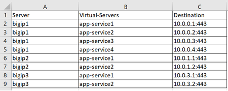

Problem this snippet solves: This is a simple cli script used to collect all the virtual-servers name, its destination created in a server or ltm server. A sample output would be like below, How to use this snippet: This is similar to my other share - https://devcentral.f5.com/s/articles/Export-GTM-DNS-Configuration-in-CSV-tmsh-cli-script Login to the GTM/DNS, create your script by running the below commands and paste the code provided in snippet, tmsh create cli script gtm-vs Delete the proc blocks, so it looks something like below, create script gtm-vs { ## PASTE THE CODE HERE ## } and paste the code provided in the snippet. Note: When you paste it, the indentation may be realigned, it shouldn't cause any errors, but the list output would show improperly aligned. Feel free to delete the tab spaces in the code snippet & paste it while creating, so indentation is aligned properly. And you can run the script like below, tmsh run cli script gtm-vs > /var/tmp/gtm-vs-output.csv And get the output from the saved file, open it on excel. Format it & use it for audit & reporting. cat /var/tmp/gtm-vs-output.csv Feel free to add more elements as per your requirements. Code : proc script::run {} { puts "Server,Virtual-Server,Destination" foreach { obj } [tmsh::get_config gtm server] { set server [tmsh::get_name $obj] foreach { vss } [tmsh::get_config gtm server $server virtual-servers] { set vs_set [tmsh::get_field_value $vss virtual-servers] foreach vs $vs_set { set vs_name [tmsh::get_name $vs] puts $server,$vs_name,[tmsh::get_field_value $vs destination] } } } } Tested this on version: 13.11.7KViews3likes2CommentsSample Linux script to update CRL file from Certificate Authority
