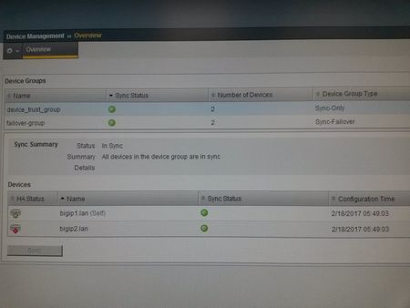

Hi, I've an Active/Active cluster and for an unknown reason, I can't Sync the config. When I do a change on one of the LTM , nothing happen. I've created the "Device Group" and added the two device in, I've set it to "Manual with Full Sync". Even after a change, the device status stay "In Sync".975Views0likes7CommentsBIGIP DNS - What configuration get replicated by Sync group
