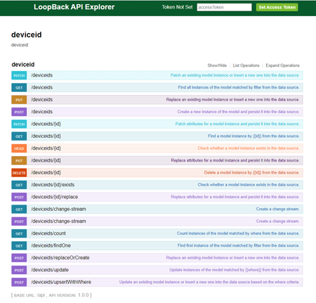

This article covers the use case to use APM and an external API Server to store DeviceID+. As you learnt in the previous articles in this series, DeviceID+ is a way to "identify" a user. And of course, it is a great solution to combine with F5 APM (Access Policy Manager) - https://www.f5.com/products/security/access-policy-manager The F5 Shape DeviceID+ solution does not store the IDs anywhere. It is up to you to store/use/consume them on your own. To do so, I propose to use an external API Server to store the DeviceID / Username peer. Steps: Built an API server based on loopback.io stack. You can download the project (docker-compose) here : https://github.com/MattDierick/DeviceID-api-server/blob/main/README.md Build an APM Pre Request Policy with HTTP Connector to query the API server (available also on my Github) Created the Postman collection (available also on my Github) First of all, watch the demo video to understand the use case and the outcomes: https://www.youtube.com/watch?v=PVYwh76nGVE The API Server: The API server has a Swagger UI installed so you can "watch" the API (go to /explorer) Structure of the API Below is the structure of the API payload. As you can see, we store the username with the associated DeviceIDs { "username": "dierick", "deviceid": [ "Ac31A2AAAAAA12uwoekcLffhgfjgjghj", "AUq7Xti2Eowm6yVog4CYvt6nRrookqgW" ] } The REST calls used by APM 1. GET DeviceID per username GET /api/deviceids/findOne?filter={"where":{"username":"dierick"}} 2. POST a new DeviceID POST /api/deviceids HTTP/1.1 { "username": "dierick", "deviceid": [ "Ac31A2AAAAAA12uwoekcLffhgfjgjghj", "AUq7Xti2Eowm6yVog4CYvt6nRrookqgW" ] } 3. UPDATE DeviceID per username POST /api/deviceids/upsertWithWhere?where={"username": "dierick"} HTTP/1.1 { "deviceid": [ "Rtdsflkj534565465kenfter" ] } The iRule to collect the DeviceID from the Shape cookie when ACCESS_SESSION_STARTED { log local0. "Access Session Started" if [HTTP::cookie exists _imp_apg_r_] { set deviceid [URI::decode [HTTP::cookie _imp_apg_r_]] log local0. "URL Decoded cookie is $deviceid" set deviceida [lindex [regexp -inline -- (?:"diA":")(.*?)(?:") $deviceid] 1] log local0. "diA = $deviceida" set deviceidb [lindex [regexp -inline -- (?:"diB":")(.*?)(?:") $deviceid] 1] log local0. "diB = $deviceidb" log local0. "IP is [IP::client_addr]" log local0. "Path os [HTTP::path]" ACCESS::session data set session.logon.deviceid $deviceid ACCESS::session data set session.logon.deviceid.A $deviceida ACCESS::session data set session.logon.deviceid.B $deviceidb } else { log local0. "No cookie" } } The APM Per Request Policy Below an example using the APM Per Request Policy. A Per Request Policy is required instead of a Per Session Policy in order to use the HTTP Connector. HTTP Connector is a REST API client. Create the different CALLS, and assign each call in the right branch (new DeviceID, update DeviceID ...)1.1KViews5likes0Comments
