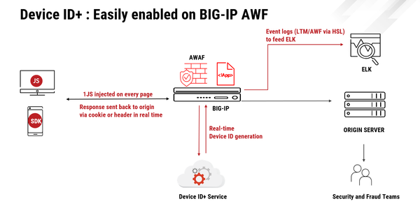

While I was already using HSL (High Speed Logging) to log BIG-IP LTM / AWF related information to ELK Stack and did correlation with help of different Dashboards, the goal was to enrich that log information with a unique Device Identifier to create simple ratios, that can provide strong intel on sudden fluctuations.
Simple ratios that can provide strong intel with sudden fluctuations
The overall Architecture - where Device ID+ has been onboarded to BIG-IP using the following documented process: Getting started with F5 Device ID+

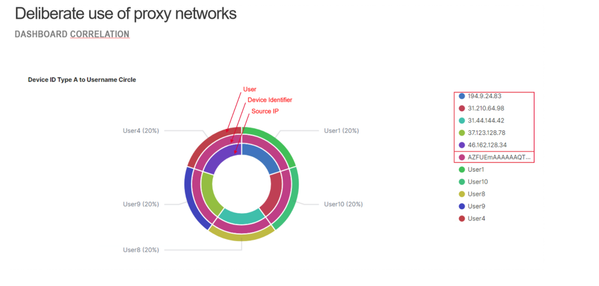

A sudden change over a short duration, such an hour or a day, may indicate that some users are deliberately changing their IP addresses through the use of proxy networks, a likely signal of an attack. If discovered, investigate the network requests from Device IDs with high numbers of IP addresses.
The visualization within ELK is showing a Unique Device Identifier associated with different IP Addresses, however, this single device tried to access multiple accounts on an application.

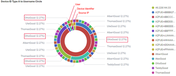

The visualization within ELK is showing multiple Device Identifier behind a single IP Address trying to access an application unauthorized by using a user account called "OttoGood".
