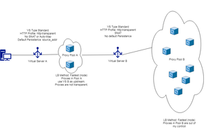

Hello fellow F5-experts, My situation: I try to loadbalance Web-Proxy traffic. In genenal it seems to work, but we've run into some problems relating to websites with weird session handling. I sketched up the environment in the following Image A clients uses VS-A as it's HTTP proxy. This VS loadbalances to two of our own proxies in Pool A. Those are not transparent, so outgoing traffic toward their upstream proxy (VS-B) will have the Pool A node's IP as source address. The Proxies use the HTTP: Connect method. VS-B on the other hand, has a Pool B attached with a lot (as in really a lot) other proxy servers, that are not under our control (but are trustworthy, and have to be used. No way around it). VS-A: Type Standard HTTP-Profile: http-transparent (to be able to use LB method Fastest (node)) Source Address Translation: none Default Persistence Profile: source_addr Pool A: LB Method: Fastest (node) VS-A: Type Standard HTTP-Profile: http-transparent (to be able to use LB method Fastest (node)) Source Address Translation: SNAT Default Persistence Profile: none Pool B: LB Method: Fastest (node) Problem: On some websites, people complain about loosing their sessions. I tracked it down to the VS-B, which can not persist connections to a website to the same node in Pool B. Since the VS-B does not see the original client IP, but only the 2 proxy IP's I have no idea how to establish a propper persistence. For a very important website, i wrote an iRule that "hard-binds" to a single Node in Pool B, based on the HTTP:URI. My question: Is my config any viable? Or what should I change? I read a lot of article here, but I never had the feeling, that those met my situation with the "2-stage" proxy environment. I was thinking about adding a http header with the original client IP by an iRule in VS-A so I have something to make a persistence decision in VS-B, but I'm not sure how to do that. I also often read about applying the OneConnect profile combined with proxy loadbalancing, but I don't think I really understood the reason and/or benefit, nor do I know where to apply it in this environment. I hope I made it some kind of clear what I try to accomplish and where the problems are, since English is not my mother language and I'm a but rusted using it. Any help or hint is very much appreciated. Thanks in advance, ichnafi EDIT:(28th Feb) I just found out, that the desired website can be acquired from the HTTP::host header even by Vs-B. So would it be possible to establish a persinstence for the combination client IP and HTTP::host header? EDIT2: Possible Solution found (1st Mar) I currently endet up with an iRule creating a universal persistence based on the http::host header. the iRule is then bound to a universal Persistense-Profile. The iRule looks lilke this: when HTTP_REQUEST { persist uie [HTTP::host] } I'm thinking of maybe creating a custom header that contains a combination of client_ip and http:host value to get an even more definite persistence, but not quite sure about that. What do you guys think?1KViews0likes12CommentsFTp proxy via iRule
