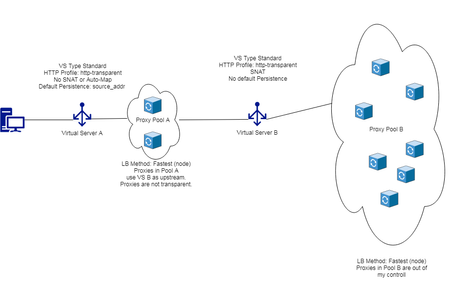

I have an F5 load balancing setup configured with two servers. My MVC web application, which incorporates Kendo UI, Jquery, and bootstrapping, is hosted on an IIS server with an SSL certificate. However, when accessing the application via HTTPS from outside the server, it often or sometimes results in a 'net::ERR_CONNECTION_RESET' error, with intermittent failures to load javascript and CSS files to the client browser. Strangely, upon reloading the page, the assets load properly, and the page functions as expected. This issue did not occur when the application was accessed via HTTP, where it worked properly without any issues. What could be the reason behind this problem?1.4KViews0likes2CommentsLoadbalancing a 2-stage proxy environment - persistence problems
Hello fellow F5-experts, My situation: I try to loadbalance Web-Proxy traffic. In genenal it seems to work, but we've run into some problems relating to websites with weird session handling. I sketched up the environment in the following Image A clients uses VS-A as it's HTTP proxy. This VS loadbalances to two of our own proxies in Pool A. Those are not transparent, so outgoing traffic toward their upstream proxy (VS-B) will have the Pool A node's IP as source address. The Proxies use the HTTP: Connect method. VS-B on the other hand, has a Pool B attached with a lot (as in really a lot) other proxy servers, that are not under our control (but are trustworthy, and have to be used. No way around it). VS-A: Type Standard HTTP-Profile: http-transparent (to be able to use LB method Fastest (node)) Source Address Translation: none Default Persistence Profile: source_addr Pool A: LB Method: Fastest (node) VS-A: Type Standard HTTP-Profile: http-transparent (to be able to use LB method Fastest (node)) Source Address Translation: SNAT Default Persistence Profile: none Pool B: LB Method: Fastest (node) Problem: On some websites, people complain about loosing their sessions. I tracked it down to the VS-B, which can not persist connections to a website to the same node in Pool B. Since the VS-B does not see the original client IP, but only the 2 proxy IP's I have no idea how to establish a propper persistence. For a very important website, i wrote an iRule that "hard-binds" to a single Node in Pool B, based on the HTTP:URI. My question: Is my config any viable? Or what should I change? I read a lot of article here, but I never had the feeling, that those met my situation with the "2-stage" proxy environment. I was thinking about adding a http header with the original client IP by an iRule in VS-A so I have something to make a persistence decision in VS-B, but I'm not sure how to do that. I also often read about applying the OneConnect profile combined with proxy loadbalancing, but I don't think I really understood the reason and/or benefit, nor do I know where to apply it in this environment. I hope I made it some kind of clear what I try to accomplish and where the problems are, since English is not my mother language and I'm a but rusted using it. Any help or hint is very much appreciated. Thanks in advance, ichnafi EDIT:(28th Feb) I just found out, that the desired website can be acquired from the HTTP::host header even by Vs-B. So would it be possible to establish a persinstence for the combination client IP and HTTP::host header? EDIT2: Possible Solution found (1st Mar) I currently endet up with an iRule creating a universal persistence based on the http::host header. the iRule is then bound to a universal Persistense-Profile. The iRule looks lilke this: when HTTP_REQUEST { persist uie [HTTP::host] } I'm thinking of maybe creating a custom header that contains a combination of client_ip and http:host value to get an even more definite persistence, but not quite sure about that. What do you guys think?1.1KViews0likes12CommentsFTp proxy via iRule
