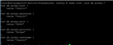

Hello Everyone,
I'm having an issue here where I'd like to totally remove the Proxy Configurations.As what happens here is that the ASM tries to resolve <null> as a domain so the update fails.
We are using TMOS v14.1
Thanks in advance!

      Hello Mohamed_Ahmed_Kansoh ,
      Thanks for your response, but this is the opposite of what I'm trying to acheive.
      We decided we don't want to use the proxy service that's why the proxy.host is <null>
      However, during the auto upadtes the ASM tries to resolve the <null> as if the proxy is configured.
      2022-12-22 12:14:40 ERROR Curl:53 - Curl fail: exit = 5, /usr/bin/curl -X POST -H Content-Type: text/xml;charset=UTF-8 -H SOAPAction: SoftwareUpdate --user [email protected]:DPIautoSIGupdate -H User-Agent: bigip/14.1.4 -d @- --proxy https://<null>:9400 https://callhome.f5.com/soa/softwareupdate/ , with error:   % Total    % Received % Xferd  Average Speed   Time    Time     Time  Current
                                       Dload  Upload   Total   Spent    Left  Speed
        0     0    0     0    0     0      0      0 --:--:-- --:--:-- --:--:--     0curl: (5) Could not resolve proxy: <null>
