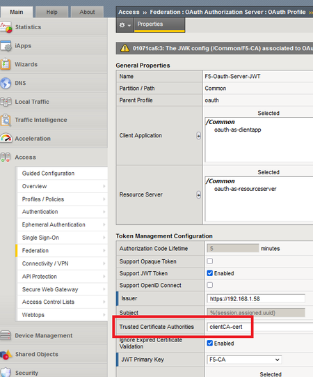

Hello to All, I tried using F5 as an OAUTH server that generates JWT tokens on 16.1.3.2 but I get the error "01071ca5:3: The JWK config (/Common/F5-CA) associated to OAuth profile (/Common/F5-Oauth-Server-JWT) failed trust verification with trusted CA bundle (/Common/clientCA-cert). " . I generated my own CA cert following "K14499: Using OpenSSL to create CA and client certificates (11.x - 16.x" https://support.f5.com/csp/article/K14499 Maybe I am doing something wrong or it is a bug but I am not certain as I do not have not worked with F5 as an Oauth JWT server. I am checking just really fast with the community as this is not something critical but if someone has seen this I will be happy to get a feedback 🙂 With or without Certificate Chain it is the same error or X5C. I am wondering as the certificate is 2048 bits RSA ifit should be 256 but I think this shouldn't matter. As a workaround I am using Octed JWT Key with a long shared password generated by a password generator that works. Also I tested with opaque keys as shown in https://support.f5.com/csp/article/K14391041 and it works but with those keys I do not think there is a way the F5 Auth server to return some usefull info like AD groups/emails to to the Oauth Client that is another F5 device as with JWT this is done with Claims. I did not find if F5 as an Oauth Authorization server supports UserInfo Request URI where after the authorization code that the web browsers provide is exchanged for Opaque Access token to configure what info the F5 Oauth Server to provide to the F5 Oauth Client but maybe some knows this. To bad that for OpenID Connect the JWT needs first to be enabled for the Oauth profile and thisagain means using Octed JWT Keys for either Access or ID tokens 😞1.1KViews0likes2CommentsAPM JWT Multiple Providers NOT WORKING

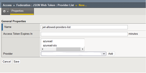

Dear F5 community, Using F5 APM 16.1.3 (as an oauth resource server) I am trying to implement a per-request policy that will verify the signature of JWT tokens sent by the client. These JWT tokens can be issued from two differents issuer (Azure AD or STS). I am able to verify JWT tokens for each provider seperatly using a dedicated "JWT provider" with only one Provider attached. When using 2 providers as follow I got following error message: WWW-Authenticate: Bearer error="invalid_token",error_description="Issuer Mismatch : Claim issuer= https://sts.windows.net/ Provider issuer=https://login.microsoftonline.com/v2.0" Based on F5 doc below, the built-in object supports having multiple JWT providers https://clouddocs.f5.com/cli/tmsh-reference/v15/modules/apm/apm_oauth_jwt-provider-list.html Configuration is pretty simple: - 1 Access Policy with "Allow" all ending - 1 Per-Request Policy with "OAuth Scope" set to "Internal" with the "jwt-allowed-providers-list" I guess It is most likely a bug. Anyone was able to make it work with multiple JWT providers ? I can workaround this by parsing the JWT payload, then determining the issuer and based on the issuer make two branches in the VPE: - first branch with the "oauth scope A" that will validate the token using JWT-Provider-A - second branch with the "oauth scope B" that will validate the token using JWT-Provider-B Thanks2.4KViews1like5Commentsoauth server generated jwt token problem
