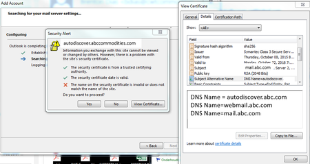

Dear all, the SSL certificate in my current virtual server points to autodiscover.abc.com and not autodiscover.abccommodities.com I would like F5 to redirect from autodiscover.abccommodities.com to autodiscover.abc.com in hopes to eliminating the SSL security warning popup from Outlook clients as seen below. Is that possible? I tried this iRule but it wasn't working, still prompts warning. I believe Outlook client is using HTTPS traffic to contact the mail server? when HTTP_REQUEST { if { [string tolower [HTTP::host]] ends_with ".abccommodities.com" } { HTTP::redirect "https://autodiscover.abc.com" } }Solved1.5KViews0likes6CommentsF5 webmail exchange 2016 - "Access policy evaluation is already in progress for your current session."
