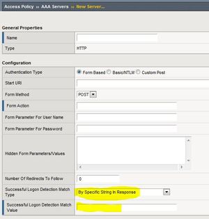

with APM, I need to build the following flow - user logs on APM logon page, credentials are validated with LDAP auth - those credentials are sent to an existing auth webserver, with a POST (HTTP auth) - that auth webserver replies with the same username (as the one sent in the form) if authorized Question: can we use session variable in the "Successful Logon detection match value" field, as we look for "specific string in response"? Anyone successfully implemented that?182Views0likes0CommentsNTLM Machine Account Issues - APM
