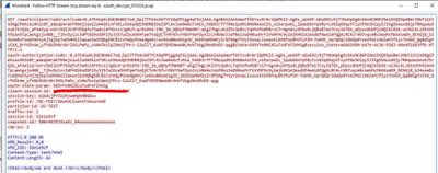

    i suggest do tcpdump with ssl decryption to see more details:
    tcpdump -s 0 --f5 ssl .....
    • southern_nordic's avatar
      southern_nordic
      I ran a tcpdump and got the following below. I see the request being made towards Azure and see the 200 OK. Is there a way I could see if the Authorizatino token is received from Azure back to APM?

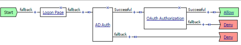

  • Hi Southern_Nordic,
    Should you try some test policy like follows:
    OAuthClientToAzureAD_act_oauth_client_ag: OAuth Client: failed for server '/DC-TEST/Azure_Oauth_Server' using 'authorization_code' grant type (client_id=XXXXXXXXXXXXXXXX), error: Failed to perform curl: Failure when receiving data from the peer

  • Thanks for the comprehensive response but we simply followed this F5 guide
    https://my.f5.com/manage/s/article/K53313351
    Could you perhaps confirm what we followed incorrectly in this guide an dif there is another guide we should use?
    You mentioned
    "The token_rejected error in OAuth means that the oauth_token is unacceptable to the Service Provider"
    Do we have to set the correct token somewhere? Once again we simply followed the guide and created the policy as attached. We can try to run a tcpdump to confirm and will also double check the credentials (client and secret)
    The test policy you suggested seems to have AD auth which we do not have the option to do. We simply want the APM to send the Oauth request to Azure AD and respond with the necessary tokens for the client to authenticate.
