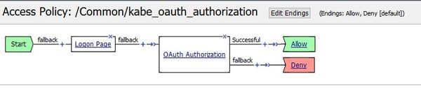

I want to use OpenID Connect to authenticate my users before gaining access to one of my application. I want to use my bigip as OpenID Provider (ie: the entity that authenticate the users) . My issue is the following: The OpendID provider (my bigip) never provides me with a ID Token. All I have is an “Access Token” and a “Refresh Token” but no “ID Token”.
Below is a description of my lab:
  • resource owner: ip address 10.10.255.1
  • bigip OpenID Provider: virtual server ip 10.10.255.221 (see below for the access policy)
*The agents are left with their default values.
  • Client: I user openid debugger (https://oidcdebugger.com/) in order to request the authorization code. Then I request the Tokens using an html code.

Could you please help me configure my access policy so that it supports OpenID Connect and sends me an “ID Token” ??
