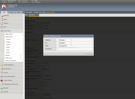

Dear F5 Expert Now i have implementation BIG-IP APM SSL VPN Auth with AD and Machine Cert Auth, For AD auth is work fine. But for Machine Cert Auth i found debug log is found Cert and verify key success. But i don't know why APM didn't forward client to authen page. Here's my configure SSL Self sign with ZERO SSL my SSL profile root domain and chain to ZERO SSL APM VPE i just verifu machine cert and allow 2 option verify key and not verify, i just check SN cert only. here's CA profile, i just use CA Cert from ZERO SSL and the last one here's Log on utility and access report Info 2024-03-03 16:23:18:016 \CertCheckImpl.cpp, CCertCheckImpl::Verify, Store name:"MY", Store location:"LocalMachine", Subject match FQDN:"false", Allow elevation UI:"true", Serial number(HEX):"00898ad22f5f67b4c15e15187d63d0592a", Issuer:"", SubjectAltName:"" Info 2024-03-03 16:23:18:016 \CertCheckImpl.cpp, CCertCheckImpl::Verify, certInfo:STORE_NAME:MY&STORE_LOCATION:LocalMachine&ALLOW_ELEVATION:1&MATCH_FQDN:0&SN:00898ad22f5f67b4c15e15187d63d0592a&ISSUER:&SAN:, RootCertInfo:IS_TRUSTED:0, Nonce: cWQ2NDNQZHpDbzdKNnRvbWN5SW8= Info 2024-03-03 16:23:18:017 \certinfo.cpp, CCertInfo::FindCertificateInStoreExt:, Total certs tested: 1 Info 2024-03-03 16:23:18:017 \certinfo.cpp, CCertInfo::FindCertificateInStoreExt:, Found matched certificate Info 2024-03-03 16:23:18:023 \certinfo.cpp, CCertInfo::IsPrivateKeyPresent, GetPrivateKey succeeded: found private key. Info 2024-03-03 16:23:18:023 \CertCheckImpl.cpp, CCertCheckImpl::CheckPrivateKey, The machine certificate has private key on this machine Info 2024-03-03 16:23:18:033 \CertCheckImpl.cpp, CCertCheckImpl::Verify, Found key successfully using current user Info 2024-03-03 16:23:18:033 \CertCheckImpl.cpp, CCertCheckImpl::CheckPrivateKey, Signing message succeeded Info 2024-03-03 16:23:18:066 CUAgentHost::downloadNextAgent() - sending request to server "https://www.kotchagorn.com:10443/my.policy_host?dummy=45b47b8aeb5c96285f65f295ffa35237" Info 2024-03-03 16:23:18:067 CUAgentHost::downloadNextAgent() - POST data "version=2.0&client_data=c2Vzc2lvbj0xMzJhNWY3YzhlYzgxODg5MmNiNjJhZmQ4M2MzYjFjYyZkZXZpY2VfaW5mbz1QR0ZuWlc1MFgybHVabT Info 2024-03-03 16:23:18:166 <URL>/logon</URL> Info 2024-03-03 16:23:18:170 EPCHECK \f5/EPCheck/MultiInstancePolicy.h, f5::EPCheck::MultiInstancePolicy<class EventSink>::stop, waiting for worker thread to exit Info 2024-03-03 16:23:19:534 EPCHECK \f5/EPCheck/MultiInstancePolicy.h, f5::EPCheck::MultiInstancePolicy<class EventSink>::run, worker thread exit Info 2024-03-03 16:23:19:536 EPCHECK \f5/EPCheck/MultiInstancePolicy.h, f5::EPCheck::MultiInstancePolicy<class EventSink>::stop, worker thread exit Info 2024-03-03 16:23:19:545 CUAgentHost::~CUAgentHost() - enter Info 2024-03-03 16:23:19:545 CAtlBrCon()::~CAtlBrCon() Info 2024-03-03 16:23:19:545 CUAgentHost::~CUAgentHost() - exit Info 2024-03-03 16:23:19:547 EPCHECK wWinMain, Endpoint check server process finished (res), 0 2024-03-03 23:23:18 /Common/Kotchagorn_vpn:Common:83c3b1cc: Session variable 'session.check_machinecert./Common/Kotchagorn_vpn_act_machinecert_auth_ag.certificate_revoked' set to '0' 2024-03-03 23:23:18 /Common/Kotchagorn_vpn:Common:83c3b1cc: Session variable 'session.check_machinecert./Common/Kotchagorn_vpn_act_machinecert_auth_ag.certificate_verified' set to '0' 2024-03-03 23:23:18 /Common/Kotchagorn_vpn:Common:83c3b1cc: Session variable 'session.check_machinecert./Common/Kotchagorn_vpn_act_machinecert_auth_ag.error_message' set to ' X509_verify_cert failed: error #: 20 at depth 0, error message:unable to get local issuer certificate ' 2024-03-03 23:23:18 /Common/Kotchagorn_vpn:Common:83c3b1cc: Session variable 'session.check_machinecert./Common/Kotchagorn_vpn_act_machinecert_auth_ag.result' set to '0' 2024-03-03 23:23:18 /Common/Kotchagorn_vpn:Common:83c3b1cc: Session variable 'session.check_machinecert./Common/Kotchagorn_vpn_act_machinecert_auth_ag.signature_verified' set to '1' 2024-03-03 23:23:18 /Common/Kotchagorn_vpn:Common:83c3b1cc: Session variable 'session.check_machinecert.last.certificate_revoked' set to '0' 2024-03-03 23:23:18 /Common/Kotchagorn_vpn:Common:83c3b1cc: Session variable 'session.check_machinecert.last.certificate_verified' set to '0' 2024-03-03 23:23:18 /Common/Kotchagorn_vpn:Common:83c3b1cc: Session variable 'session.check_machinecert.last.error_message' set to ' X509_verify_cert failed: error #: 20 at depth 0, error message:unable to get local issuer certificate ' 2024-03-03 23:23:18 /Common/Kotchagorn_vpn:Common:83c3b1cc: Session variable 'session.check_machinecert.last.result' set to '0' 2024-03-03 23:23:18 /Common/Kotchagorn_vpn:Common:83c3b1cc: Session variable 'session.check_machinecert.last.signature_verified' set to '1' 2024-03-03 23:23:18 /Common/Kotchagorn_vpn:Common:83c3b1cc: Session variable 'session.policy.inspectionhost.status' set to 'done' Anyone please guide me please Best Regards,155Views0likes0CommentsBIG-IP Next Access presentation/demo
