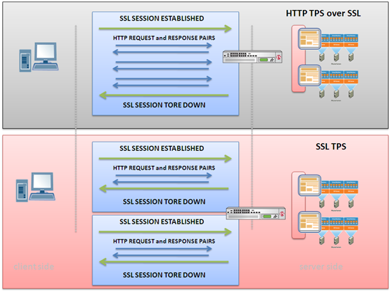

Some of the terminology used to describe specific performance metrics in application delivery, however, can be misleading. The difference between SSL TPS (Transactions per second) and HTTP TPS over SSL, for example, are significant and therefore should not be used interchangeably when comparing performance and capacity of any solution – that goes for software, hardware, or some yet-to-be-defined combination thereof.
The reasons why interpreting claims of SSL TPS are so difficult is due to the ambiguity that comes from SSL itself. SSL “transactions” are, by general industry agreement (unenforceable, of course) a single transaction that is “wrapped” in an SSL session. Generally speaking one SSL transaction is considered:
1. Session establishment (authentication, key exchange)
2. Exchange of data over SSL, often a 1KB file over HTTP
3. Session closure
Seems logical, but technically speaking a single SSL transaction could be interpreted as any single transaction conducted over an SSL encrypted session because the very act of transmitting data over the SSL session necessarily requires SSL-related operations. SSL session establishment requires a handshake and an exchange of keys, and the transfer of data within such a session requires the invocation of encryption and decryption operations (often referred to as bulk encryption).
Therefore it is technically accurate for SSL capacity/performance metrics to use the term “SSL TPS” and be referring to two completely different things.
This means it is important that whomever is interested in such data must do a little research to determine exactly what is meant by SSL TPS when presented with such data. Based on the definition the actual results mean different things. When used to refer to HTTP TPS over SSL the constraint is actually on the bulk encryption rate (related more to response time, latency, and throughput measurements), while SSL TPS measures the number of SSL sessions that can be created per second and is more related to capacity than response time metrics. It can be difficult to determine which method was utilized, but if you see the term “SSL ID re-use” anywhere, you can be relatively certain the test results refer to HTTP TPS over SSL rather than SSL TPS. When SSL session IDs are reused, the handshaking and key exchange steps are skipped, which reduces the number of computationally expensive RSA operations that must be performed and artificially increases the results.
