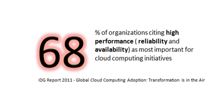

Interestingly enough, a 2011 IDG report on global cloud computing adoption shows that high performance (availability and reliability) are the most important – 5% higher than security. Amazon’s epic failure will certainly do little to alleviate concerns that public cloud computing is not ready for mission critical applications.
