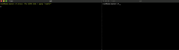

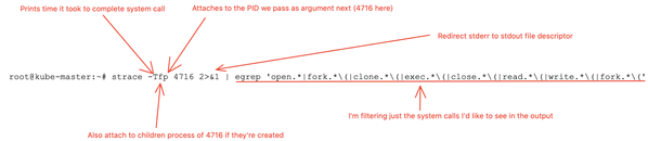

The strace command
First off, I'm using strace command which intercepts and prints system calls called by a process¹ and the signals² received by a process.
If I didn't add the redirection 2>&1, the egrep command wouldn't work because it filters the file descriptor (FD) 1 (stdout) but strace writes to FD 2 (stderr).
Note that I'm attaching strace to my bash shell process ID (4716).
Fir this reason, I added the -f option to capture the shell's behaviour of creating a new child sub-shell process in order to execute ls
It does that because if Linux were to execute ls directly, ls program would take over current process (bash shell) resources and we would not be able to go back to it once ls executed because ls would be no longer available as it's just been overwritten.
Instead, bash shell creates an exact copy of itself by calling clone() system call and then executes ls so that ls resources are written to this new process and not to parent process.
In fact, this new cloned process becomes ls.
Interesting eh?

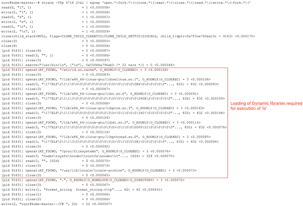

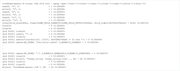

Strace output
I can't it's raw output because I've filtered it out but this is what I'm going to explain:
In fact, let's work on the output without the shared libraries:
Typing "ls" and hitting Enter
By default, Linux prompt writes to FD 2 (standard error) which also prints to terminal, just like standard output.
When I hit the letter l on my keyboard, Linux reads from my keyboard and writes back to terminal:
Both read() and write() system calls receive:
  • file descriptor they're reading from/writing to as first argument
  • the character as second argument
  • the size in bytes of the character
What we see here is  read() reads from FD 0 (standard input - our keyboard) and writes using write() to FD 2 (standard error) and that ends up printing letter "l" in our terminal.
The return value is what's after the equals sign and for both read() and write() it's the number of bytes read/written.
If there was an error somehow, the return value would be -1.
Bash shell creates a new process of itself
The clone() system call is used instead of fork() because fork() doesn't allow child process to share parts of its execution context with the calling process, i.e. the one calling fork().
Modern Linux now mostly uses clone() because there are certain resources (such as file descriptor table, virtual memory address space, etc) that are perfectly fine to be shared between parent ↔ child so clone() ends up being more efficient for most cases.
So here, my Debian 10.x uses clone() system call:
Up to this point, the above process is almost an exact replica of our bash shell except that it now has a memory address (stack) of its own as stack memory cannot be shared¹.
flags contains what is shared between the parent process (bash shell) and the new process (the sub-shell that will turn into "ls" command shortly).
The flag CLONE_CHILD_CLEARTID is there to allow another function in the ls code to be able to clean up its memory address.
For this reason, we also have to reference the memory address in child_tidptr=0x7f3ce765ba10 (this 0x.. is the actual memory address of our ls command).
The CLONE_CHILD_SETTID stores the child's PID in memory location referenced by child_tidpt.
Lastly, SIGCHLD is the signal that "ls" process will send to parent process (bash shell) once it terminates.
¹A stack is the memory region allocated to a running program that contains objects that are statically allocated such as functions and local variables. There's another region of memory called the heap that store dynamic objects such as pointers. Stack memory is fast and automatically frees memory. Heap memory requires manual allocation using malloc() or calloc() and freeing using free() function. For more details, please refer to this article here.
Execution of ls finally starts
I had to filter out other system calls to reduce the complexity of this article.
There are other things that happen like memory mappings (using mmap() system call), retrieval of process pid (using getpid() system call), etc.
Except for last 2 lines which is literally reading a blank character from terminal and then closing it, I'd just ignore this bit as it's referring to file descriptors that were filtered:

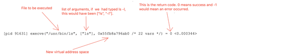

The important line here is this one:
In reality, execve() doesn't return upon success so I believe the 0 here is just strace signalling there was no error.
What happens here is execve() replaces current virtual address space (from parent process) with a new address space to used independently by ls program.
We now finally have "ls" as we know it loaded into memory!

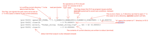

ls looks for content in current directory
The next step is for ls command to list the contents of the directory we asked.
In this case, we're listing the contents of current directory which is represented by a dot:
The openat() system call creates a new file descriptor (number 3) with the contents of current directory that we listed and then closes it.
Contents are then written to our terminal using write() system call as shown above.
Note that strace truncates the full list of directories but it displays the correct amount of bytes written (62 bytes).
If you're wondering why FD 3 is closed before ls writes its contents to FD 1 (stdout), keep in mind that strace output is not the actual ls code!
It's just the system calls, i.e. when code needs access to a privileged kernel operation.

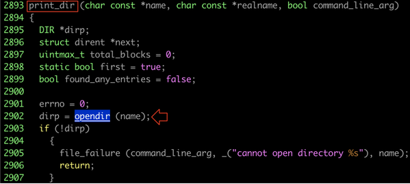

This snippet from ls.c from Linux coreutils package, shows that ls code has a function called print_dir and inside such function, it uses a native C library function opendir() to store the contents of the directory into a variable called dirp.
In reality, it's not the directory's content but a pointer to it.
The openat() system call is triggered when print_dir function executes opendir() as seen below:
The bottom line is that strace will only show us what is going on from the point of view of system calls.
It doesn't give us a complete picture of everything that's going on in ls code.
So to answer our question, opendir() function only uses openat() system call to have access to the contents of current directory.
It can then copy it to variable and close it immediately.
Terminal prompt gets printed back to us
After program closes, Linux prints our terminal prompt back to us:
