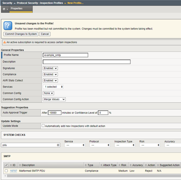

Great news! F5 products can help here – BIG-IP AFM has Protocol Inspection functionality which can block many SMTP smuggling attempts under the “Malformed SMTP PDU” inspection:
You just need to ensure that Action is set to Reject or Drop for that inspection and that your inspection profile is associated with your SMTP Virtual Server. The BIG-IP AFM Operations Guide has more documentation on how to use Protocol Inspection.
Note: The only caveat to the above is that the Malformed SMTP PDU inspection cannot block or drop SMTP requests where the line ending is <CR>.<CR> which is a known smuggling technique against Cisco Secure Email Gateway – if you use Cisco Secure Email Gateway as your receiving MTA then you should follow the advice in SEC Consult’s blog and change CR & LF Handling to Reject.
