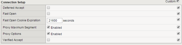

Connection Setup
The big performance enhancer here is Fast Open. I discussed this in great detail earlier, and it can make a big difference for short connections. Fast Open Cookie Expiration specifies how long the cookie that the BIG-IP provides to a client is valid. Set it too short, and most Fast Open attempts will end up failing due to an expired cookie. Set it too long, and that's more time for a valid cookie to end up in the wrong hands. There is no memory impact on the BIG-IP in any case.
Proxy Maximum Segment helps out the CPU a bit without having any impact on your throughput under most conditions. When the serverside profile enables this, the serverside will not advertise an MSS that results in TCP data payloads that can't fit in a clientside MSS. This saves the effort of rewriting packets into separate memory. It accounts for options that might take up space on one side but not the other.
Proxy Options and Verified Accept are about signaling across the proxy. Proxy Options, when selected on the serverside profile, won't request timestamps on the serverside if it's not enabled on the clientside. Enable this if your servers are interested in this information. Verified Accept won't respond to a client SYN packet until it receives a SYN/ACK from the server. Thus your clients will (accurately) get a non-response from the server rather than a SYN/ACK followed by a TCP Reset. This might be important for security scans on your servers. On the other hand, this delays additional connection data from the client. Also note that Verified Accept changes the way that iRule events work, so use it with care.
Lastly, there is Deferred Accept, which is a defense against DoS attacks. BIG-IP won't set up anything above TCP on the clientside, or anything at all on the serverside, until the client completes the three-way-handshake. The reduces the per-connection overhead during a SYN flood, but once again slow things up on the serverside.
