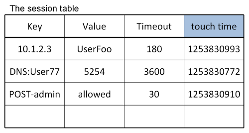

Remember that I mentioned that an entry also has metadata? Prior to v10.1, the only metadata that an entry had was a timestamp, which keeps track of when that entry was last touched (changed or queried), and a timeout. The touch timestamp can’t be directly set by iRules, of course. It’s used internally by the session table to keep track of when to expire entries. So a small session table might have looked like this:
You can see a number of different types of keys and values, each one with a timeout and a timestamp. One common request to enhance the session table has been to have some way of looking up an entry without affecting the touch timestamp, so we added the -notouch flag to the table command:

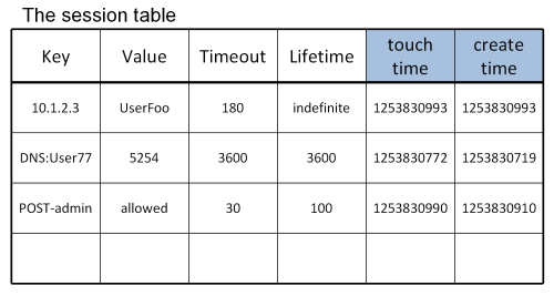

With this flag, you can query the session table without changing when the entries will expire. But we felt that that didn't go far enough for some uses, so while the session table looks much the same in v10.1, it has two additions:
Just as before, an entry has a touch timestamp and can have a timeout, but now it also has a create timestamp (to record when the entry was created), and it can also have a lifetime. By setting a lifetime on an entry, you can have it expire after a certain period of time no matter how many changes or lookups are performed on it. An entry can have a lifetime and a timeout at the same time. It will expire (be removed from the table) whenever the timeout OR the lifetime expires, whichever comes first. You can just specify the lifetime right after the timeout value:
table set <key> <value> [<timeout> [<lifetime>]]
If you want an entry to only have a lifetime, and not a timeout, you can specify an indefinite timeout. For example:
table set $key $data indefinite 3600
will set an entry that will be removed after 3600 seconds. By default, an entry has a timeout of 180 seconds (just like previous versions), and an indefinite lifetime.
