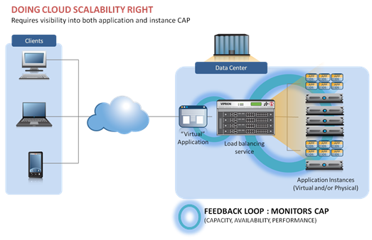

When you take this goal apart, what folks are really after is the ability to transparently add and/or remove resources to an “application” as needed to meet demand. Interestingly enough, both in pre-cloud and cloud computing environments this happens due to two key components: load balancing and automation.
Load balancing has always been used to scale applications transparently. The load balancing service provides a layer of virtualization in the network that abstracts the “real” resources providing the application and makes many instances of that application appear to be a single, holistic entity. This layer of abstraction has the added benefit of allowing the load balancing service to see both the overall demand on the “application” as well as each individual instance. This is important to cloud scalability because a single application instance does not have the visibility necessary to see load at the “application” layer, it sees only load at the application instance layer, i.e. itself.
Visibility is paramount to scalability to maintain efficiency of scale. That means measuring CAP (capacity, availability, and performance) both at the “virtual” application and application instance layers. These measurements are generally tied to business and operational goals – the goals upon which IT is measured by its consumers. The three are inseparable and impact each other in very real ways. High capacity utilization often results in degrading performance, availability impacts both capacity and performance, and poor performance can in turn degrade capacity. Measuring only one or two is insufficient; all three variables must be monitored and, ultimately, acted upon to achieve not only scalability but efficiency of scale. Just as important is flexibility in determining what defines “capacity” for an application. In some cases it may be connections, in other CPU and/or memory load, and in still others it may be some other measurement. It may be (should be) a combination of both capacity and performance, and any load balancing service ought to be able to balance all three variables dynamically to achieve maximum results with minimum resources (and therefore in a cloud environment, costs).
