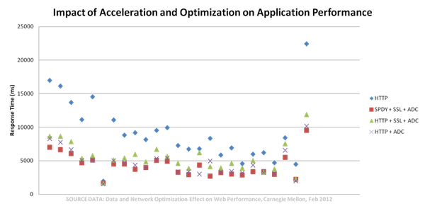

What Carnegie Mellon testing shows is that when you combine the two, you get the best results because each improves performance of specific data exchanges that occur over the life of a user interaction.
HERE COMES the DATA
The testing was specifically designed to measure the impact of each of the technologies separately and then together. For the web acceleration functionality they chose to employ BoostEdge (a software ADC) though one can reasonably expect similar results from other ADCs provided they offer the same web acceleration and optimization capabilities, which is generally a good bet in today’s market.
The testing specifically looked at two approaches:
Two of the most promising software approaches are (a) content optimization and compression, and (b) optimizing network protocols. Since network protocol optimization and data optimization operate at different levels, there is an opportunity for improvement beyond what can be achieved by either of the approaches individually. In this paper, we report on the performance benefits observed by following a unified approach, using both network protocol and data optimization techniques, and the inherent benefits in network performance by combining these approaches in to a single solution.
-- Data and Network Optimization Effect on Web Performance, Carnegie Mellon, Feb 2012
The results should not be surprising – when SPDY is combined with ADC optimization technologies, the result is both less filling and it tastes great.
When tested in various combinations, we find that the effects are more or less additive and that the maximum improvement is gained by using BoostEdge and SPDY together. Interestingly, the two approaches are also complimentary; i.e., in situations where data predominates (i.e. “heavy” data, and fewer network requests), BoostEdge provides a larger boost via its data optimization capabilities and in cases where the data is relatively small, or “light”, but there are many network transactions required, SPDY provides an increased proportion of the overall boost. The general effect is that relative level of improvement remains consistent over various types of websites.
