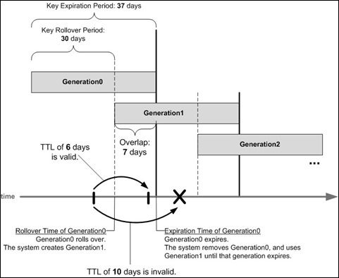

TTL Values, Key Values, and Overlaps
The following diagram shows an example of key generation timelines with rollover periods and overlaps. This diagram is useful when reviewing the configuration settings and values discussed in the section above. Notice that the expiration period must be greater than the rollover period, and the TTL must be less than the overlap period. You wouldn't want a key to expire before it rolls over; likewise, you wouldn't want a TTL period to outlast the overlap period...if it did, the key could still be valid after the expiration period.
