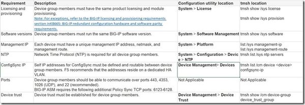

Prerequisites

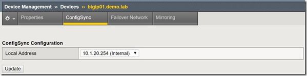

Define a ConfigSync Address on the Devices to Share APM Configs
  • Navigate to Device Management >> Devices.
  • Click the device listed.
  • Select the ConfigSync tab.
  • From the drop-down menu, select a local address to be used.
Note: I am using the Internal Self IP for demonstration purposes.
  • Repeat this step on the other device to be synced.

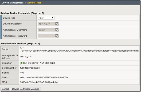

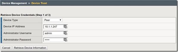

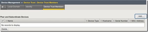

Configuring a Device Trust
  • Navigate to Device Management >> Device Trust : Device Trust Members.
  • Click Add.
  • Device Type: Peer
  • Device IP Address: Management or Self IP address of the peer
  • Administrator Username: admin
  • Administrator Password: the admin password

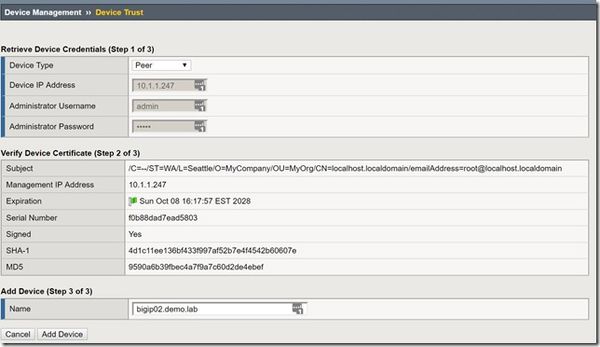

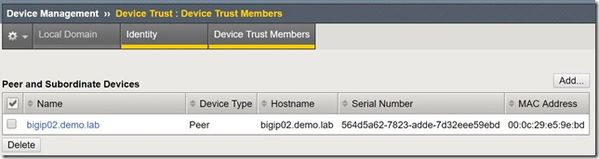

  • Click Retrieve Device Information.
  • Click Device Certificate Matches.
  • Click Add Device.

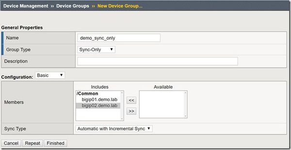

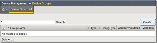

Create a Sync-Only Device Group
  • Navigate to Device Management >> Device Groups.
  • Click Create.
  • Name: demo_sync_only
  • Group Type: Sync-Only
  • Members: Include the BIG-IP's to be synced
  • Sync Type: Automatic with Incremental Sync
  • Click Finished.

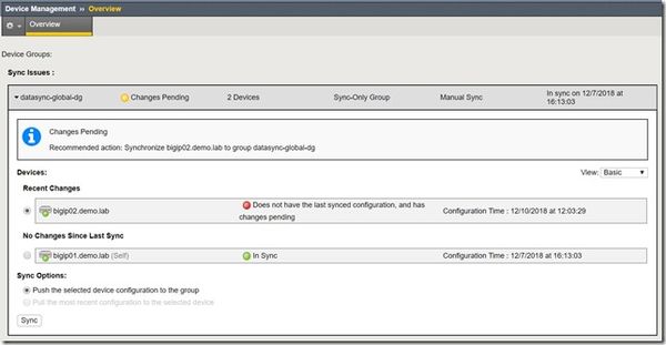

Perform Initial Sync of Device Groups if Prompted with Changes Pending
In the event you receive a notice of Changes Pending, perform a sync of Manual Sync Groups. Though the device group created in the previous steps is Automatic, there are global sync groups and trust groups created during the process of establishing trusts. Believe me, there is no need to worry. The device group that was created in this how-to will be synced automatically without manual intervention.
  • Click Changes Pending from the top left of the TMUI.
  • Identify the Device Group that is not in sync.
  • Click Sync.
Note: If you have issues syncing, a quick step would be to delete the Device Group, ensure all other default device groups have synced and recreate the Device Group.

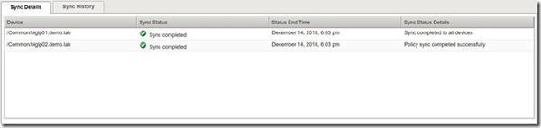

  • Click Sync.
  • Once you see a completed status, view the Sync Details to ensure a successful sync.

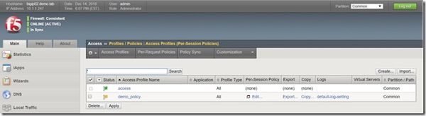

  • Log into the device that was receiving the sync and validate the Access Policy exists and review all settings.
You have now successfully synced Access Policies across appliances in separate datacenters or cloud regions. Until next time!
