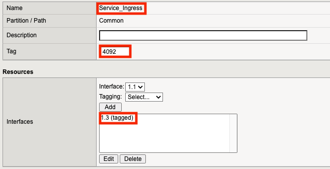

Create a VLAN for Service1 Ingress.  In this example interface 1.3 is being used.  This must also be a Tagged interface.  When done it should look like this:

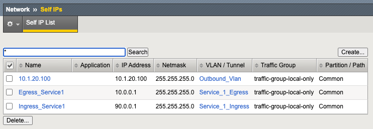

Next we’ll configure the Self IPs for these VLANs.  Navigate to Self IPs under Network.
Create 2 Self IPs like the following:
Name
IP Address
Netmask
VLAN
Egress_Service1
10.0.0.1
255.255.255.0
Service_Egress
Ingress_Service1
90.0.0.1
255.255.255.0
Service_Ingress

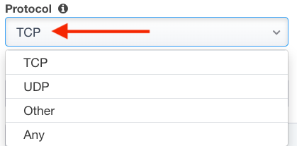

Select the Protocol needed, TCP in this example.

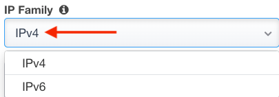

Select the IP Family, IPv4 in this example.

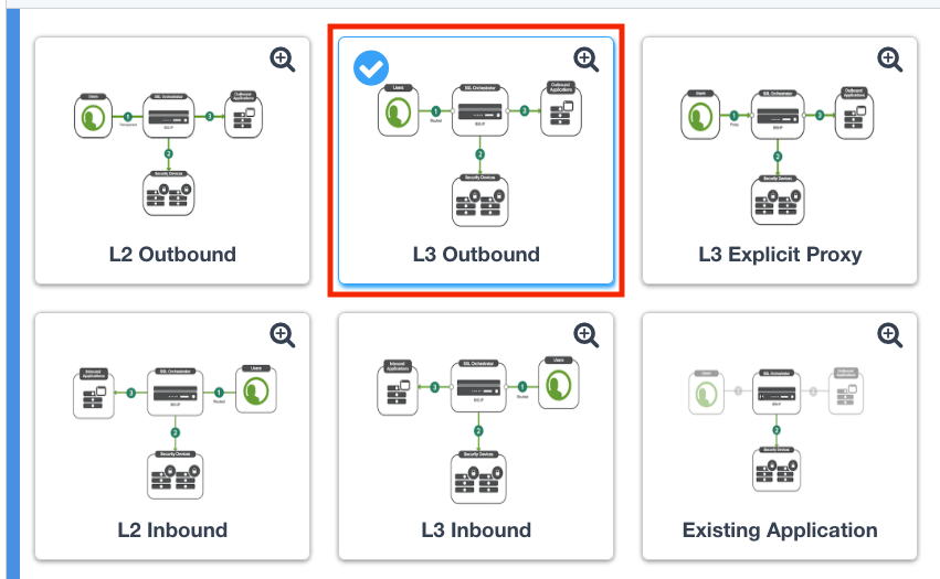

Select the Topology type, L3 Outbound in this example.
Note: L3 Inbound is also compatible with One-Armed Mode.

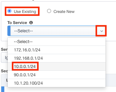

For the To Service Configuration select Use Existing then click the down arrow to expand the dialog box.  Select the Egress IP address for Service1, 10.0.0.1/24 in this example.

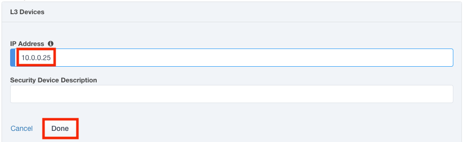

Enter the IP address of your L3 Security device, 10.0.0.25 in this example.  Click Done.

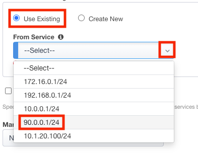

For the From Service Configuration select Use Existing then click the down arrow to expand the dialog box.  Select the Ingress IP address for Service1, 90.0.0.1/24 in this example.

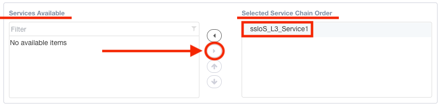

Select the Service under Services Available and click the right arrow to move it under Selected Service Chain Order.

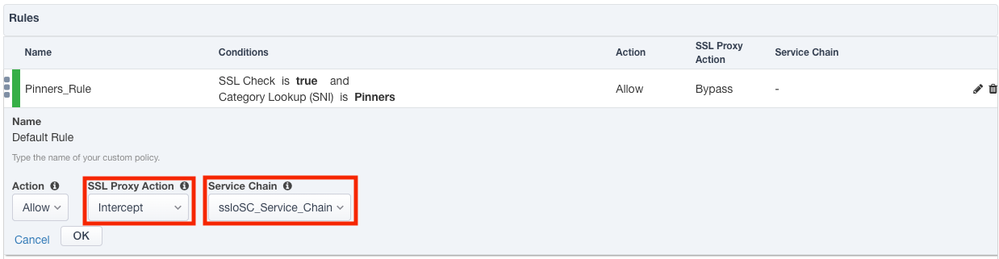

The Security Policy screen is where you enable/disable SSL Proxy and specify the Service Chain to use.  Click the pencil (edit) icon on the bottom rule to set the Service Chain.
Click OK.

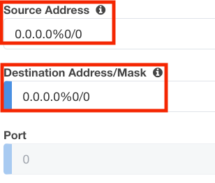

For the Interception Rule optionally specify the Source Address.  The Destination Address/Mask field is required.  In this example the policy is configured to intercept connections from and to any IP address.

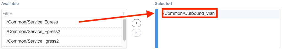

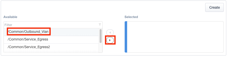

Select the correct vlan from the Available options, Outbound_Vlan in this example, and click the right arrow to move it to Selected.

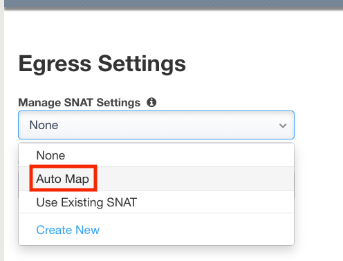

For SNAT Settings select Auto Map.

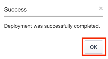

Click Deploy at the bottom of the page.
You should see a Success message.  Click OK.

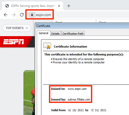

Test the SSL decryption capabilities by connecting to an HTTPS site, espn.com in this example.
The connection to the site is secure, there are no certificate errors and the certificate was Issued By subrsa.f5labs.com.
\n
\n
\n
\n
\n
\n
\n
\n
\n
\n
\n
\n
\n
\n
\n
\n
\n
\n

The Default Gateway of the client computer is set to 10.1.20.100 which is the Self IP of the BIG-IP.
\n
\n
\n
\n
\n
The client computer has already been configured to trust the SSL certificates emulated by BIG-IP SSL Orchestrator.
\n\n\n\n\n\n\n\n\n\n\n\n\n\n\n\n\n\n\n\n\n\n
\n
Name
\n
\n
IP Address
\n
\n
Netmask
\n
\n
VLAN
\n
\n
Egress_Service1
\n
\n
10.0.0.1
\n
\n
255.255.255.0
\n
\n
Service_Egress
\n
\n
Ingress_Service1
\n
\n
90.0.0.1
\n
\n
255.255.255.0
\n
\n
Service_Ingress
\n
\n
\n
\n
\n
\n
\n
\n
\n
\n
\n
\n
\n
\n
\n
\n
\n
\n
\n
\n
\n
\n
\n
\n
\n
Click Save at the bottom.

Give it a name, Service_Chain in this example.
\n
\n
\n
\n
\n
\n
\n
\n
\n
\n
\n
\n
\n
\n
\n
\n
\n
\n
\n
Click OK.
\n
\n
\n
\n
\n
\n
\n
\n
\n
\n
\n
\n
\n
