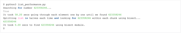

Here's our test script:
The function above creates a list of 900 million sorted numbers and then searches for a random number between 1 million and 900 million.
In our example below, the in operator will go through ~623 million steps before it can find number 623358246 but bisect will only go through 29 steps:
It took 58 seconds for in operator to find number 623358246 but bisect was so fast that even 2 decimal numbers only were not enough to display the time it took below 1 second.
