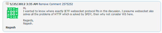

A recent post on the HTTP 2.0 War beginning garnered a very relevant question regarding WebSockets and where it fits in (what might shape up to be) an epic battle.
The answer to the question, “Why not consider WebSockets here?” could be easily answered with two words: HTTP headers. It could also be answered with two other words: infrastructure impact.
But I’m guessing Nagesh (and others) would like a bit more detail on that, so here comes the (computer) science.
