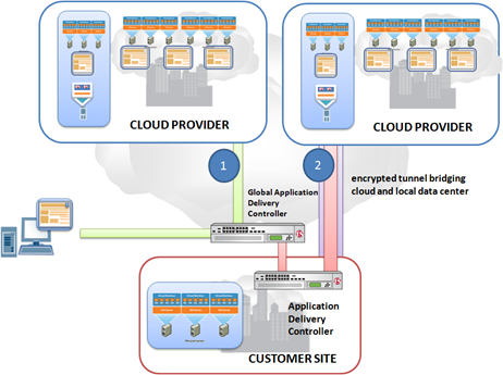

In the scenario in which the cloud is “attached” to your data center it actually becomes an extension of your existing architecture. This is the “private virtual cloud” scenario in which the resources provisioned in a public cloud computing environment are not accessible to the general Internet public directly. In fact, customers/users should have no idea that you are leveraging public cloud computing as the resources are obfuscated by leveraging the many-to-one virtualization offered by an application delivery controller (load balancer).
The data center is extended and connected to this pool of resources in the cloud via a secured (encrypted) and accelerated tunnel that bridges the network layer and provides whatever routing may be necessary to treat the remote application instances as local resources. This is simply a resource-focused use of VPN (virtual private network), one that was often used to integrate remote offices with the corporate data center as opposed to individual use of VPNs to access a corporate network. Amazon, for example, uses IPSEC as a means to integrate resources allocated in its environments with your data center, but other cloud computing providers may provide SSL or a choice of either. In the case that the provider offers no option, it may be necessary to deploy a virtual VPN endpoint in the cloud in order to achieve this level of seamless connectivity.
Once the cloud resources are “attached” they can be treated like any other pool of resources by the application delivery controller (load balancer).
[ This is depicted by connection (2) in the diagram ]

A potentially simpler exercise (in both the house and cloud scenarios) is to treat the cloud-deployed resources as “detached” from the core networking and data center infrastructure and integrating the applications served by those resources at the global application delivery layer.
[ This is depicted by connection (1) in the diagram ]
In this scenario the application delivery network and resources it is managing are all deployed within an external cloud environment and can be accessed publicly (if one were to determine which public IP address was fronting them, of course). You don’t want users/customers accessing those resources by some other name (you’d prefer www.example.com/remoteapp over 34.35.164.4-cloud1.provider.com of course) and further more you want to be able to make the decision when a customer will be using the detached cloud and when they will be using local data center resources. Even if the application deployed is new and no copy exists in the local data center you still want to provide a consistent corporate naming scheme to ensure brand identity and trust that the application is yours.
Regardless, in this case the detached cloud resources require the means by which customers/users can be routed to them; hence the use of global application delivery infrastructure. In this case users attempt to access www.example.com/remoteapp and are provided with an IP address that is either local (in your data center) or remote (in a detached cloud environment). This resolution may be static in that it does not change based on user location, capacity of applications, or performance or it may take into consideration such variables as are available to it: location, performance, security, device, etc… (context).
