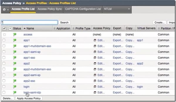

We’ll start with App1’s Access Profile.

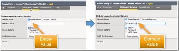

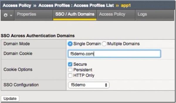

Once you click through to App1’s settings, in the Top menu, select SSO/Auth Domains.
For the Domain Cookie, we’ll set the value to f5demo.com since App1 and App2 use this domain and it is a FQDN. Of course, click Update.
Next, we’ll select App2’s Access Profile. Like App1, we select SSO/Auth Domains and set the Domain Cookie value to f5demo.com.

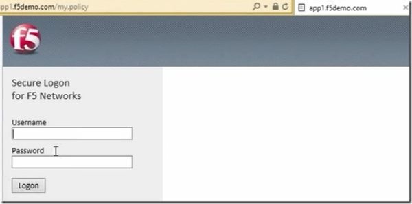

To make sure it works, we’ll launch App1 in our browser.
We’re prompted for authentication and enter our credentials and luckily, we have a successful login.

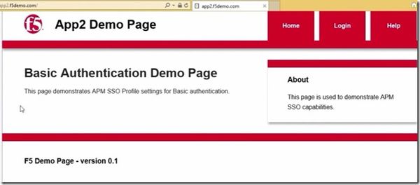

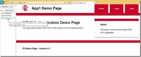

And then we’ll try to login to App2. And when we click it, we’re not prompted again for authentication information and gain access without prompts.
