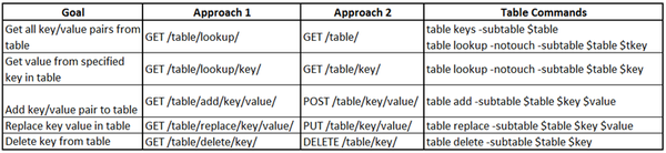

REST came about as a lightweight response to the heavyweight champ SOAP standard for web services.  With REST, the HTTP methods are used as an API.  I’ll use two approaches here.  The first is a cheat of sorts.  It’s pretty common for developers to put the parameters in the URI instead of using PUT and DELETE, so I’ll show that first.  With the second approach, I’ll use the normal REST methods (GET/POST/PUT/DELETE) to determine the operation.  The table below (no pun intended) shows the actions the iRule will take given the request.

As shown in the table above, for approach one, every request will be a get, so I need an action keyword to tell the iRule what table operation to use.  The actions are lookup, add, replace, & delete.  For the second approach, the HTTP method is used as the operator, so I only need to supply the table information.  I built a class to control which tables could be accessed and manipulated, but one should probably put more controls (source IP’s allowed, maybe some authentication) around it as well.  Finally, I’m using indefinite on the timeout and lifetime just so I don’t have to worry about my k/v pairs disappearing during testing.  This might not be desirable in a production environment as indefinite times X connections/second could lead to a very large and perhaps catastrophic memory footprint.
