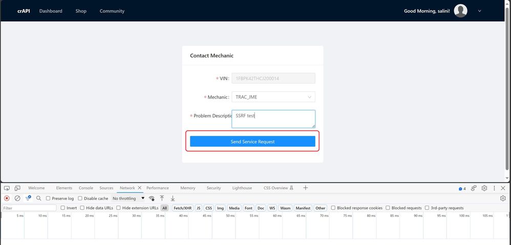

  1. Access the application using Load Balancer domain name. Create an account and login to the application using the created credentials.
  2. Navigate to Dashboard section and observe the vehicle details page.

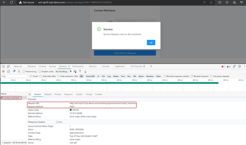

  3. Click on ‘Contact Mechanic’ and provide required details like Mechanic name, Problem Description and send Service Request.

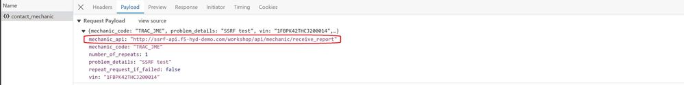

  4. Observe Endpoint and payload details while making the service request. Below image shows that ‘contact_mechanic’ endpoint is internally making a call to ‘mechanic_api’ URL. Since ‘mechanic_api’ parameter accepts URL as data, this can be vulnerable to SSRF attacks.

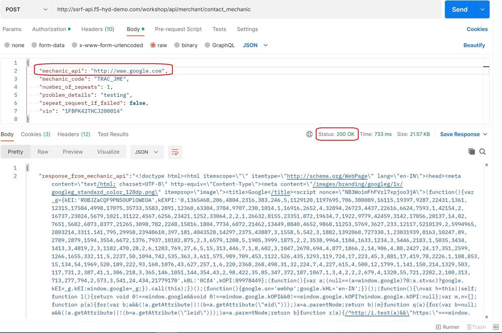

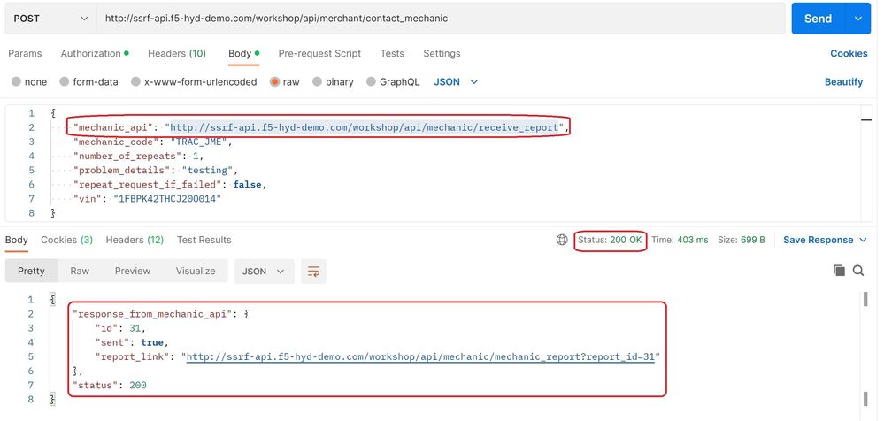

  5. As shown in the image below, using the postman tool, we can exploit the vulnerable endpoint by modifying the URL call to www.google.com in POST data and observe the response shows 200 status code. Attackers can take advantage of such endpoints and gain access to internal resources which are forbidden to access externally.

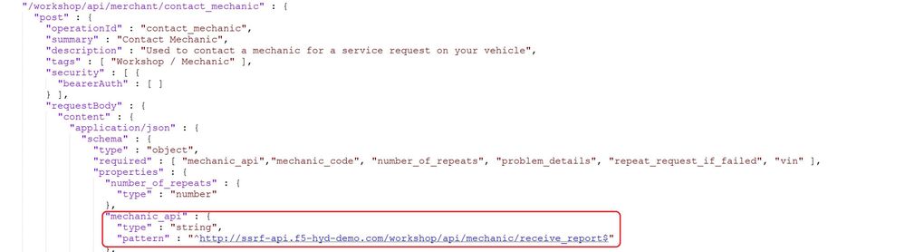

  1. Download crAPI’s swagger file from repo. Make changes in ‘contact_mechanic’ API section of swagger file to validate and allow only valid/allowed URL for ‘mechanic_api’ parameter then save it.

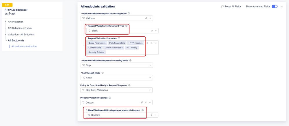

  6. Now from your LB main config page, select “All Endpoints” for “Validation” field and click “View Configuration”.
  7. Select “Validate” for “OpenAPI Validation Request Processing Mode” field, select “Block” for field “Request Validation Enforcement Type” and select all available properties in “Request Validation Properties” field.
  8. Click “Show Advanced Fields” toggle button, choose “Custom” under “Property Validation Settings”, select “Disallow” under “Allow/Disallow additional query parameters in Request” and apply the changes.
    Note:  Above configurations will allow XC to validate all the Requests to API endpoints and enforce block mode if the request parameters do not meet the requirements mentioned in the uploaded swagger file. "Allow/Disallow additional query parameters in Request" option in Advanced section helps XC to validate and block any additional query parameters that are being sent in request.

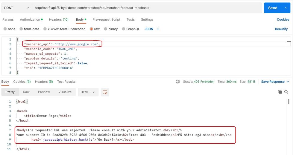

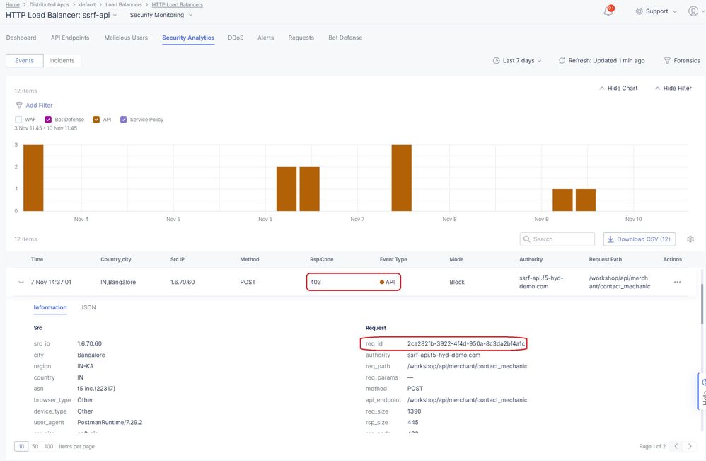

  9. Try to repeat the above attack scenario by providing www.google.com in the “mechanic_api” parameter and validate that the request is blocked.
  10. With API protection, LB allows requests which have only a valid URL endpoint.

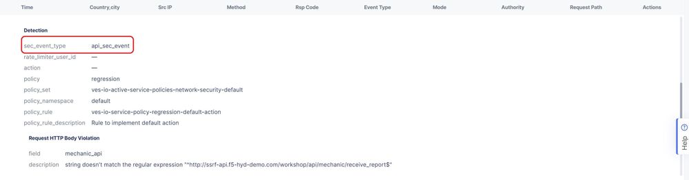

  11. Monitor the “Security Analytics” logs from F5 XC console and observe security events triggered for blocked requests.
