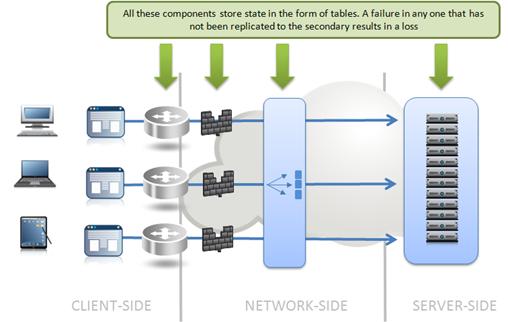

Disaster recovery plans are designed and implemented with the intention of minimizing loss. Practitioners are well aware that a zero-tolerance policy toward data loss for disaster recovery architectures is unrealistic. That is in part due to the “weakest link” theory that says a system’s is only as good as its weakest component’s .  No application or network component can perform absolutely zero-tolerance failover, a.k.a. stateful failover, on its own. There is always the possibility that some few connections, transactions or sessions will be lost when a system fails over to a secondary system. Consider it an immutable axiom of computer science that distributed systems can never be data-level consistent. Period. If you think about it, you’ll see why we can deduce, then, that we’ll likely never see stateful failover of network devices. Hint: it’s because ultimately all state, even in network components, is stored in some form of “database” whether structured, unstructured, or table-based and distributed systems can never be data-level consistent. And if even a single connection|transaction|session is lost from a component’s table, it’s not stateful, because stateful implies zero-tolerance for loss.
WHY ZERO-TOLERANCE LOSS is IMPOSSIBLE
Now consider what we’re trying to do in a failover situation. Generally speaking we’re talking about component-level failure which, in theory and practice, is much easier than a full-scale architectural failover scenario. One device fails, the secondary takes over. As long as data has been synchronized between the two, we should theoretically be able to achieve stateful failover, right?
Except we can’t. One of the realities with respect to high availability architectures is that synchronization is not continuous and neither is heartbeat monitoring (the mechanism by which redundant pairs periodically check to ensure the primary is still active). These processes occur on a period interval as defined by operational requirements, but are generally in the 3-5 second range. Assuming a connection from a client is made at point A, and the primary component fails at point A+1 second, it is unlikely that its session data will be replicated to the secondary before point A+3 seconds, at which time the secondary determines the primary has failed and takes over operation. This “miss” results in data loss. A minute amount, most likely, but it’s still data loss.
Basically the axiom that zero-tolerance loss is impossible is a manifestation in the network infrastructure of Brewer’s CAP theorem at work which says you cannot simultaneously have Consistency, Availability and Partition Tolerance. This is evident before we even consider the slight delay that occurs on the network despite the use of gratuitous ARP to ensure a smooth(er) transition between units in the event of a failover, during which time the service may be (rightfully) perceived as unavailable. But we don’t need to complicate things any more than they already are, methinks.
What is additionally frustrating, perhaps, is that the data loss could potentially be caused by a component other than the one that fails. That is, because of the interconnected and therefore interdependent nature of the network, a sort of cascading effect can occur in the event of a failover based on the topological design of the systems. It’s the architecture, silly, that determines whether data loss will be localized to the failing components or cascade throughout the entire architecture. High availability architectures based on a parallel data path design are subject to higher data loss throughout the network than are those based on cross-connected data path designs. Certainly the latter is more complicated and harder to manage, but it’s less prone to data loss cascade throughout the infrastructure.
Now, add in the possibility that cloud-based disaster recovery systems necessarily leverage a network connection instead of a point-to-point serial connection. Network latency can lengthen the process and, if the failure is in the network connection itself, is obviously going to negatively impact the amount of data lost because synchronization cannot occur at all for that period of time when the failed primary is still “active” and the secondary realizes there’s a problem, Houston, and takes over responsibility. Now take these potential hiccups and multiply them by every redundant component in the system you are trying to assure availability for, and remember to take into consideration that to fail over to a second “site” requires not only data (as in database) replication but also state data replication across the entire infrastructure.
Clearly, this is an unpossible task. A truly stateful cloud-based failover might be able to occur if the stars were aligned just right and the chickens sacrificed and the no-fail dance performed to do so. And even then, I’d bet against it happening. The replication of state residing in infrastructure components, regardless of how necessary they may be, is almost never, ever attempted.
The reality is that we have to count on some data loss and the best strategy we can  have is to minimize the loss in part by minimizing the data that must be replicated and components that must be failed over.
