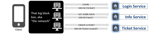

The danger is not that each service will be its on (isolated and localized) "domain", because that's the whole point of microservices in the first place. The danger is that those isolated domains will be presented to the outside world as individual, isolated domains, each requiring their own personal, private connection by clients.
Even if we assume there are load balancing services in front of each service (a good assumption at this point) that still means direct connections between the client and each of the services used by the client application because the load balancing service acts as a virtual service, but does not eliminate the isolation. Each one is still its own "domain" in the sense that it requires a separate, dedicated TCP connection.
This is essentially the same thing as domain sharding as each host requires its own IP address to which the client can connect, and its behavior is counterproductive to HTTP/2*.

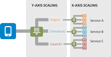

That means we need to enable a single connection between the client and the server and then utilize capabilities like Y-axis sharding (content switching, L7 load balancing, etc...) in "the network" to maintain the performance benefits of HTTP/2 to the client while enabling all the operational and development benefits of a microservices architecture.

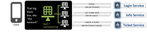

What we can do is insert a layer 7 load balancer between the client and the local microservice load balancers. The connection on the client side maintains a single connection in the manner specified (and preferred) by HTTP/2 and requires only a single DNS lookup, one TCP session start up, and incurs the penalties from TCP slow start only once. On the service side, the layer 7 load balancer also maintains persistent connections to the local, domain load balancing services which also reduces the impact of session management on performance. Each of the local, domain load balancing services can be optimized to best distribute requests for each service. Each maintains its own algorithm and monitoring configurations which are unique to the service to ensure optimal performance.

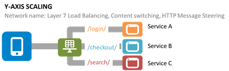

This architecture is only minimally different from the default, but the insertion of a layer 7 load balancer capable of routing application requests based on a variety of HTTP variables (such as the cookies used for persistence or to extract user IDs or the unique verb or noun associated with a service from the URL of a RESTful API call) results in a network architecture that closely maintains the intention of HTTP/2 without requiring significant changes to a microservice based application architecture.
Essentially, we're combining X- and Y-axis scalability patterns to architect a collaborative operational architecture capable of scaling and supporting microservices without compromising on the technical aspects of HTTP/2 that were introduced to improve performance, particularly for mobile applications.
Technically speaking we're still doing sharding, but we're doing it inside the network and without breaking the one TCP connection per app specified by HTTP/2. Which means you get the best of both worlds - performance and efficiency.
