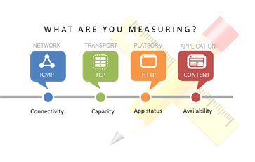

There are four primary variables you want to monitor and measure in order to have the operational data necessary to make any adjustments necessary to maintain performance and availability:
  • Connectivity
    • This determines whether or not upstream devices (ultimately, the client) can reach the app (IP). This is the most basic of tests and tells you absolutely nothing about the application except that the underlying network is reachable. While that is important, of course, connectivity is implied by the successful execution of monitors up the stack and thus the information available from a simple connectivity test is not generally useful for performance or availability monitoring. ICMP pings can also be detrimental in that they generate traffic and activity on systems that, in hyper-scale environments, can actually negatively impact performance.
  • Capacity
    • This measure is critical to both performance and availability, and measures how close to "full" the connection capacity (TCP) of a given instance is. These variables are measured against known values usually obtained during pre-release stress / load tests that determine how many connections an app instance can maintain before becoming overwhelmed and performance degrades.
  • App Status
    • This simple but important measure determines whether the application (the HTTP stack) is actually working. This is generally accomplished by sending an HTTP request and verifying that the response includes an HTTP 200 response. Any other response is generally considered an error. Systems can be instructed to retry this test multiple times and after a designated number of failures, the app instance is flagged as out of service.
  • Availability
    • This is often ignored but is key to determining if the application is responding correctly or not. This type of monitoring requires that the monitor be able to make a request and compare the actual results against a known "good" result. These are often synthetic transactions that test the app and its database connectivity to ensure that the entire stack is working properly.
App Status and Availability can be measured either actively or passively (in band). When measured actively, a monitor initiates a request to the application and verifies its response. This is a "synthetic" transaction; a "fake" transaction used to measure performance and availability. When measured passively, a monitor spies on real transactions and verifies responses without interference. It is more difficult to measure availability based on application content verification with a passive monitor than an active one as a passive monitor is unlikely to be able to verify responses against known ones because it doesn't control what requests are being made. The benefit of a passive monitor is that it isn't consuming resources on the app instance in order to execute a test and it is measuring real performance for real users.
You'll notice that there's a clear escalation "up the stack" from IP -> TCP -> HTTP -> Application. That's not coincidental. Each layer of the stack is a critical component in the communication that occurs between a client and the application. Each one provides key information that is important to measuring both performance and availability.
