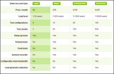

Load Impact offers four service levels, with the lowest-capable load generating service being free (as in gratis). Pricing is per month with varying numbers of users, configuration and result management, and differences in what you can/cannot configure for any given test.
I tested out the “Light” version, of course, but the site allows you to see all the configuration options – they’re just not enabled for modification if you aren’t using the right version. Load Impact does a nice job of laying out the various versions in an at-a-glance format.
