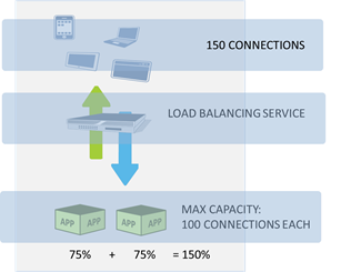

In the simplest case of two devices – one acting as backup to the other – everything is just peachy keen until utilization is greater than 50%.
Assume we have two servers, each with a maximum capacity of 100 connections. Let's assume clients are generating 150 connections and a load balancing service distributes this evenly, giving each server 75 connections for a utilization rate of 75%.
Now let's assume one server fails.
The remaining server must try to handle all 150 connections, which puts its utilization at … 150%. Which it cannot handle. Performance degrades, connections time out, and end-users become very, very angry.
