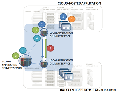

Enter live migration. Live migration of applications attempts to remove the issues inherent with pre-positioning (or no positioning at all) by migrating on-demand to a cloud computing environment and maintaining at the same time availability of the application. What that means is the architecture must be capable of:
- Transferring a very large virtual image across a constrained WAN connection in a relatively short period of time
- Launch the cloud-hosted application
- Recognize the availability of the cloud-hosted application and somehow direct users to it
- When demand decreases you must siphon users off (quiesce) the cloud-hosted application instance
- When no more users are connected to the cloud-hosted application, take it down
Reading between the lines you should see a common theme: collaboration. The ability to recognize and act on what are essentially “events” occurring in the process require awareness of the process and a level of collaboration traditionally not found in infrastructure solutions.
CLOUD is an EXERCISE in INFRASTRUCTURE INTEGRATION
Sound familiar? It should. Live migration, and even the ability to leverage pre-positioned content in a cloud computing environment, is at its core an exercise in infrastructure integration. There must be collaboration and sharing of context, automation as well as orchestration of processes to realize the benefits of applications deployed in “the cloud.” Global application delivery services must be able to monitor and infer the health at the site level, and in turn local application delivery services must monitor and infer the health and capacity of the application if cloud bursting is to successfully support the resiliency and performance requirements of application stakeholders, i.e. the business.
The relationship between capacity, location, and performance of applications is well-known. The problem is pulling all the disparate variables together from the client, application, and network components which individually hold some of the necessary information – but not all. These variables comprise context, and it requires collaboration across all three “tiers” of an application interaction to determine on-demand where any given request should be directed in order to meet service level expectations. That sharing, that collaboration, requires integration of the infrastructure components responsible for directing, routing, and delivering application data between clients and servers, especially when they may be located in physically diverse locations.
As customers begin to really explore how to integrate and leverage cloud computing resources and services with their existing architectures, it will become more and more apparent that at the heart of cloud computing is a collaborative and much more dynamic data center architecture. That without the ability not just to automate and orchestrate, but integrate and collaborate infrastructure across highly diverse environments, cloud computing – aside from SaaS - will not achieve the successes it is predicted.
