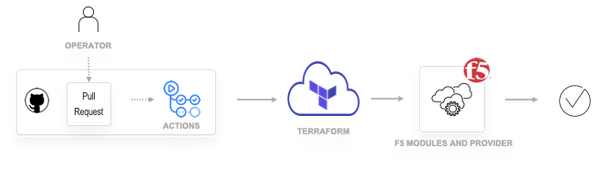

With Terraform and GitHub Actions, you can enable continuous integration and deployment practices to automate, test and deploy BIG-IP configurations as part of a pipeline.

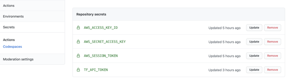

Go to https://github.com/<yourusername>/bigip-ci/settings/secrets/actions and create the secrets as shown below, also update the TF_API_TOKEN which you have created before
Enter all the secrets as shown above in your GitHub repo - AWS Secrets Key and Key ID, also update ASW_SESSION_TOKEN if you are using it.

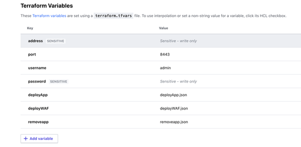

On the Terraform Cloud, under the Workspace bigip-ci update the terraform variables listed below.
BIG-IP variables - address, port, username, password.  Variable deployWAF is the AS3 configuration file that has a WAF policy referenced. You can customize this to meet your requirements.

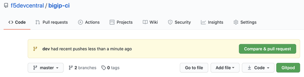

Our environment is now setup such that the Actions workflow gets trigged when there is a PULL REQUEST to the MASTER branch. Let’s test it out by committing a minor change. On the terminal execute:
# check you are pointing to which branch
git status
#  checkout to the dev branch
git checkout dev.
# add the changed files to gitHub, this will be your main.tf and deployWAF.json
git add .
git commit -m "deployWAF"
# push the files to  dev branch
git push

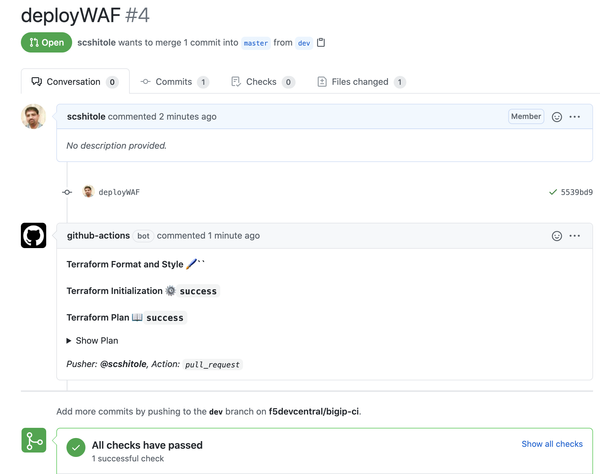

Create a pull request, merge to master to trigger the Actions Workflow
Merge the pull request:

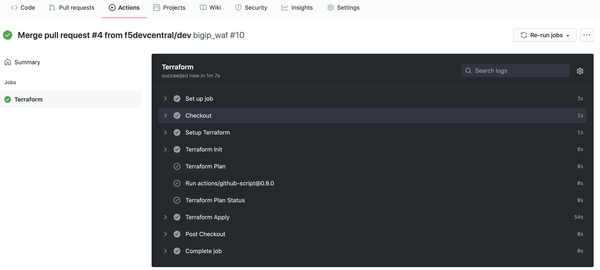

Click on the ‘Actions’ tab in your GitHub repo to see the trigged workflow as shown below:
When you click on the workflow, you can see the summary of jobs that are executed. A green check means the run was successful.

The above merge of the Pull Request executed the sample workflow at .github/workflow/bigip-ci.yml. As shown below, the workflow has various ‘event definitions’ and ‘jobs’. In this case the event is on pull_request, and the jobs are terraform runs. The jobs listed in this workflow are: Setup Terraform, Terraform Init, Terraform Plan and Terraform Apply.
