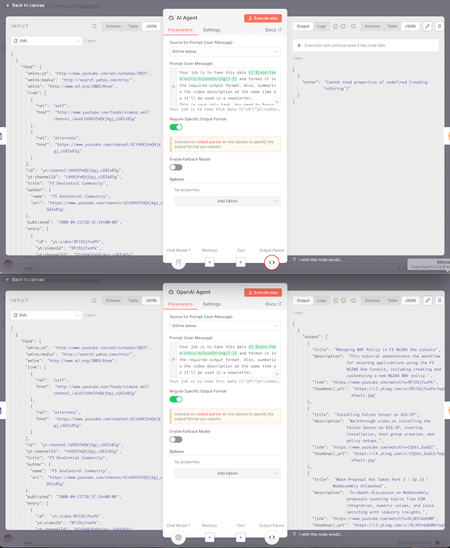

I Tried to Beat OpenAI with Ollama in n8n—Here’s Why It Failed (and the Bug I’m Filing)
Hey, community. I wanted to share a story about how I built the n8n Labs workflow. It watches a YouTube channel, summarizes the latest videos with AI agents, and sends a clean HTML newsletter via Gma...

OK.. For anyone playing along at home, here is the bug I filed on this issue.
They indicated that they thought it was a configuration issue and suggested I try the forums. I do not believe it is a configuration issue because of the output fail that I'm very clearly seeing in the Ollama node, but I'm working the process.
So, here is the n8n community forum post on the issue. I'll post more as I find out more.
