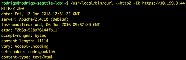

The packet capture taken below was the result of the following curl command issued from my ubuntu Linux client (I could've used a browser instead):
Note: 10.199.3.44 is my virtual server with HTTP/2 profile applied.

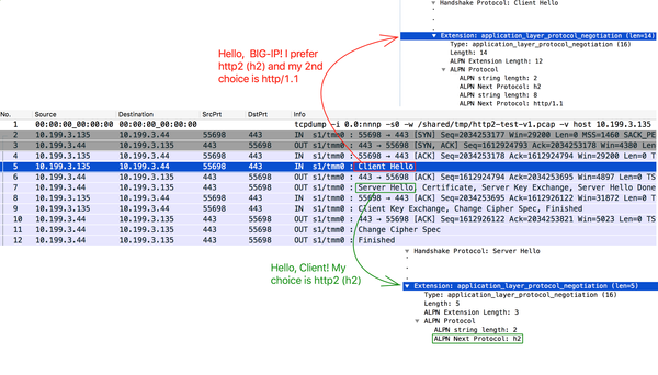

HTTP/2 is negotiated during SSL handshake in Application Layer Protocol Negotiation (RFC 7301) SSL extension like this:
Client says which protocol(s) it supports and server responds which one it picked (in this case it's HTTP/2!).

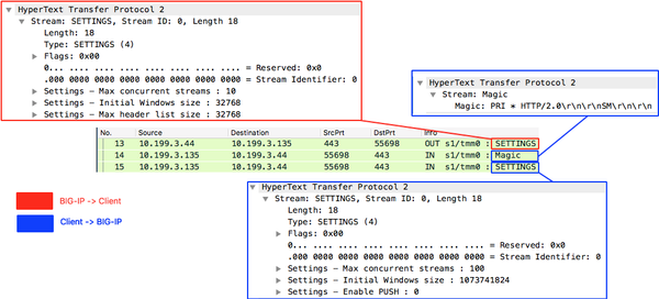

Server side (BIG-IP in this case) sends SETTINGS frame which counts as confirmation that HTTP/2 is being used plus any flow control configuration we want our peer to honour:
Client sends Magic frame to confirm HTTP/2 is being used and then SETTINGS with its requirements for the connection. Yes, Magic frame is always the same.
Still curious about Magic frame? Read https://tools.ietf.org/html/rfc7540#section-3.5.

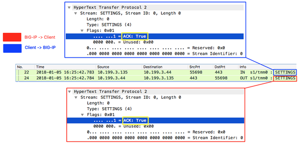

End-points are also supposed to ACK the receipt of SETTINGS frame from the other peer and the way they do it is by responding with another empty SETTINGS frame with ACK flag set:

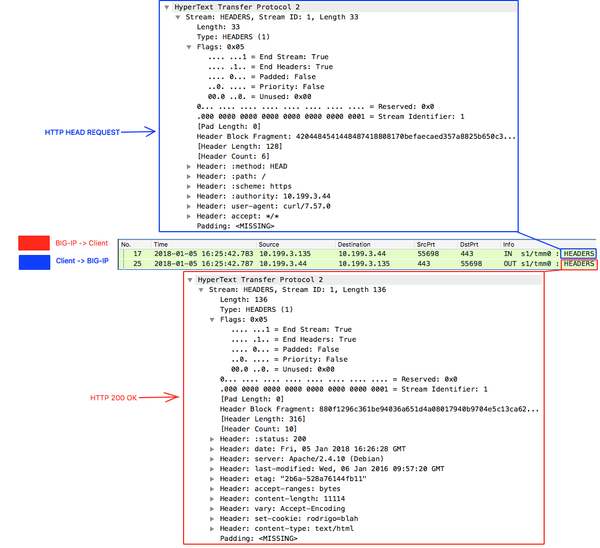

Connection-wise we're all set now. For HTTP/2 GET/HEAD requests there is a specific frame type called HEADERS which as the name implies carries HTTP/2 header information.
If there was payload it would be carried inside DATA frame type but as this is just a HEAD request then no DATA frame follows.

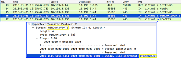

There are other common frame types and in my capture the one that came up was WINDOW_UPDATE.
If you look at section 3 above we see that Client advised BIG-IP that its Initial Window Size was 1073741824.
WINDOW_UPDATE just adjusted this value to 1073676289:
This is HTTP/2 flow control in action.

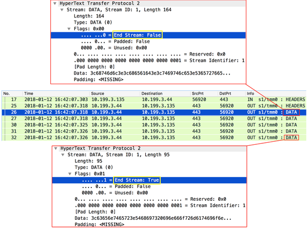

in another test (http2-v2.zip) I used HTTP/2 GET request instead of HEAD and requested more data which comes in through DATA frame type:
End Stream flag is false in all DATA messages except for the last one. It signals when there is more data as well as the last DATA frame.

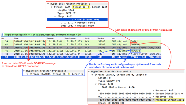

5.3 GOAWAY
In a subsequent test (http2-connection-idletimeout-1.zip) I set Connection Idle Timeout in HTTP/2 profile to 1 to force BIG-IP sending GOAWAY frame to close down connection after 1 second of idle connection.
After last piece of data is sent by BIG-IP to client (frame #39), BIG-IP waits 1 second and sends GOAWAY frame which initiates the shutdown of HTTP/2 connection.
GOAWAY messages always contains Promised-Stream-ID which tells the client what is the last Stream ID it processed.
A new Stream ID is typically created for every new HTTP request (via HEADERS message).
We can see that a new HTTP request slipped in on frame #46 but ignored as connection had already been closed on BIG-IP's side.
