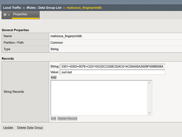

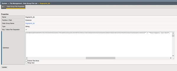

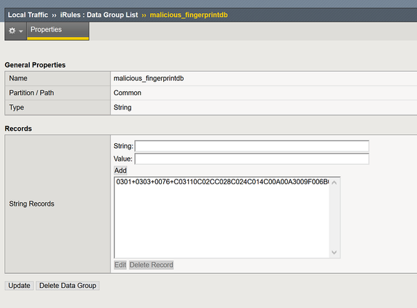

External Data Group fingerprint_db
Internal Data Group malicious_fingerprintdb
In edit mode, String and Value are exposed
