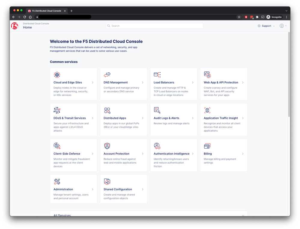

Log in to your F5 Distributed Cloud Console. (If you do not have a tenant today, you should reach out to your F5 Account Team immediately and rectify the situation!)
Landing Page Tiles
Service Policies for everyone!

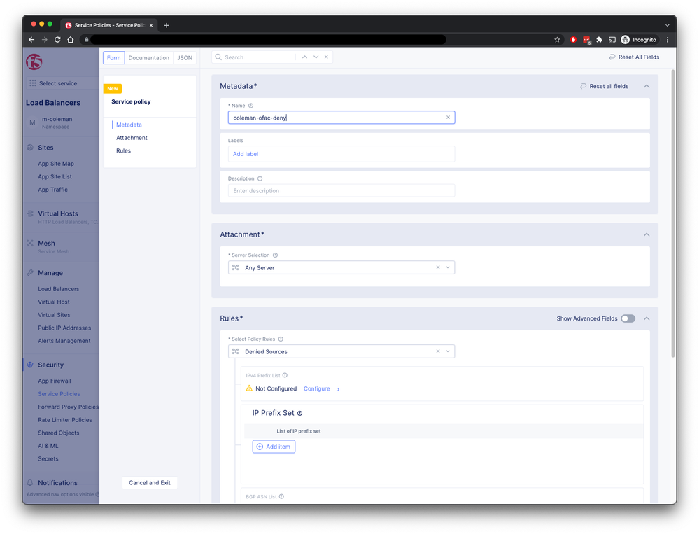

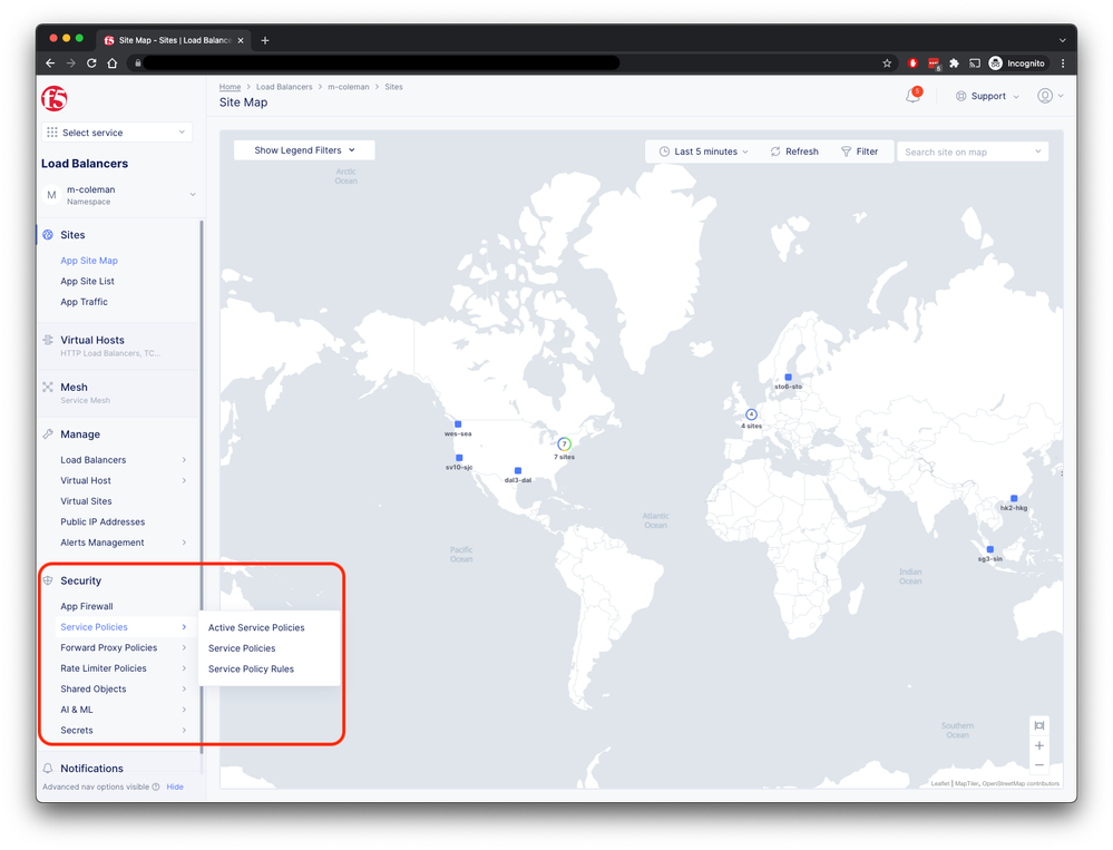

Now we need to expand Security, hover over Service Policies, Click Service Policies, and in the new window click Add service policy.
Creating Service PoliciesService Policy Rules

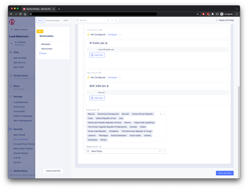

Populate the Name under metadata, leave attachment as Any Server, and set Select Policy Rules to Denied Sources.  Now, we could use IP blocks, but for this example we will just use the Country List configuration parameter and enter country codes.  This will pull from GeoIP validation.
Save and Exit.

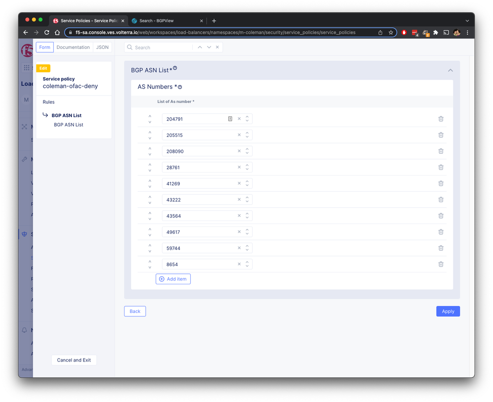

For Crimea, we need to pull from another database, so for this example I am going to pull from https://bgpview.io/search/Crimea and we are going to block by ASN.  So within our service policy, click Add item under BGP ASN Set.  And on this screen we enter in all the ASN's that we discovered from the previous link. BGP ASN List
Then click Apply.  (Making sure to now remove Ukraine from our Block List.)
Then we need to determine Default Action.  This is where you can cause some pain for yourself, so pay special attention when selecting Default action (“Default Action for requests from sources that do not belong to this list”), if you are using Next Policy, ensure the next policy allows traffic, or set the Default action to Allow, or the application will not receive any traffic.  In this example I will only be using one policy, so I will set the Default Action to Allow (as noted in the JSON).  Save and Exit.

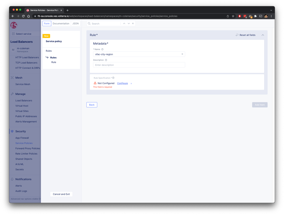

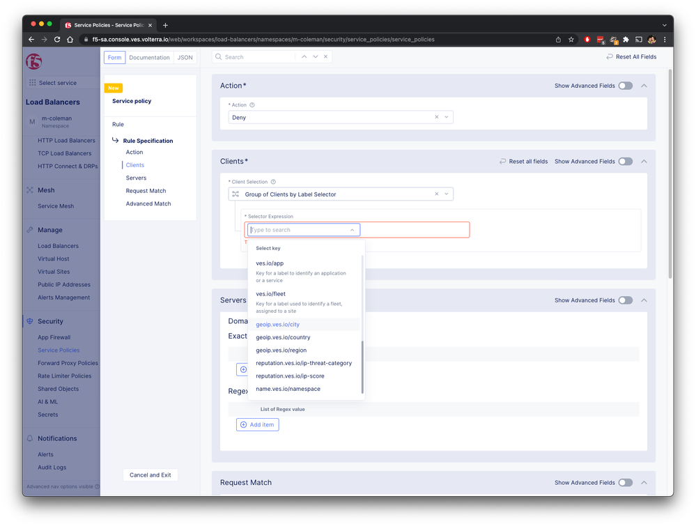

Just to keep things clean, lets add a new Service Policy.  This time, under Select Policy Rules, we are going to select Custom Rule List from the drop down.
Custom Rule List
Then from here, we want to click Configure under Rules, then Add Item.  Give our new rule a name, and click Configure under Rule Specification.
Rule NameFrom here, we are going to change the dropdown under Clients - Client Selection from Any Client to Group of Clients by Label Selector.  Then under Selector Expression, Add Label.  In the available selections you will find geoip.ves.io/city, country, and region (as well as some really cool IP Intelligence options but those are out of scope for this article.).
Selector

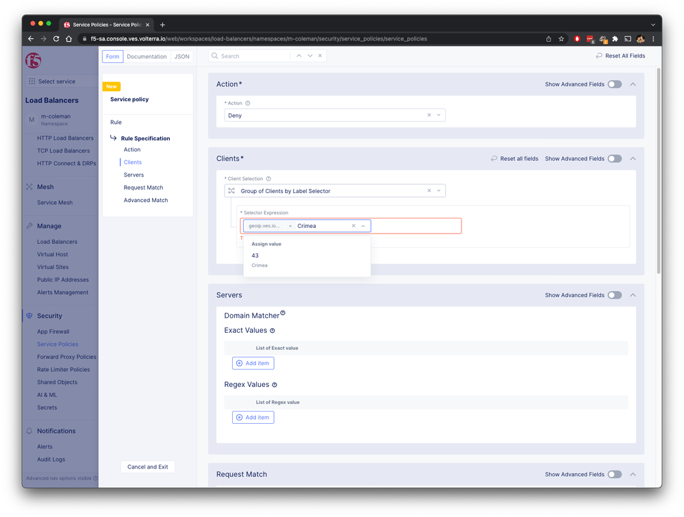

Lets do a Region first to see how that works. Selct geoip.ves.io/region, then =, then start typing a region, for example Crimea.  Once we have it set, scroll down and click Apply.
Crimea
 Now, lets add another rule, but this time we are going to select city.
City
We are already blocking Russia in our earlier policy, but just for an example lets add = Moscow.
Moscow

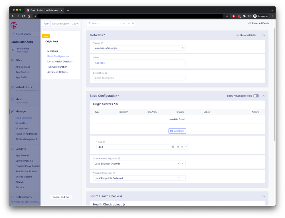

Origin Pools
Origin Pools are where we send traffic to, so if you are familiar with BIG-IP its just the Pool, and if you are familiar with NGINX its our Upstream.  All of the settings and nerd knobs that are part of origin pools are out of scope of this article, so we are just going to point our origin at a single public IP and move on.
To create an Origin Pool, Expand the Manage Block, hover over Load Balancers, click Origin Pools, and then Add Origin Pool.

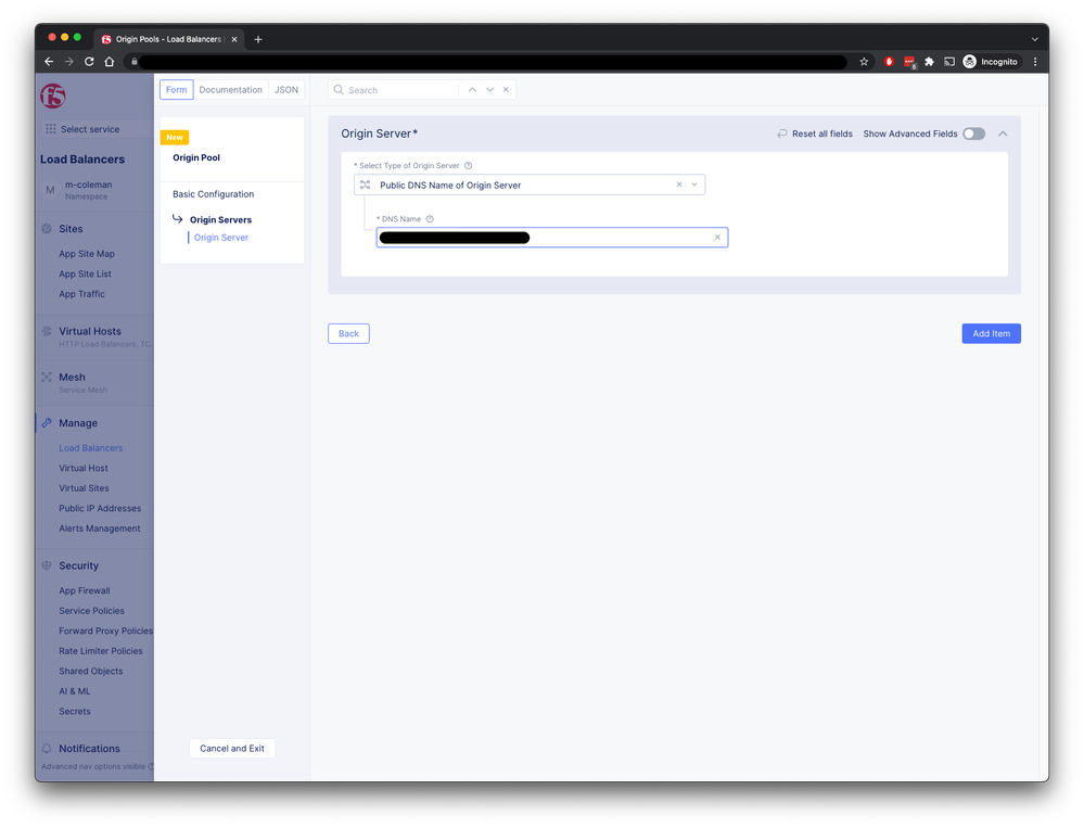

Give the Origin Pool a Name under Metadata.  Then under Origin Servers click Add Item so we can add an upstream server.  For this example I am going to use a Public DNS Name of Origin Server, but you should use whichever applies best to your situation.  Click Add Item once done, which will return us to the Origin Pool Config.  Make sure to select the correct port, and any TLS settings for your environment. Click Save and Exit.
Create Origin Pool
Origin Pool Destination

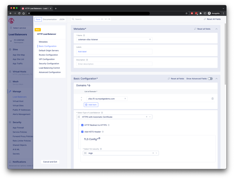

Now that we have somewhere to send traffic, we need a way to receive traffic and assign security policies.  We will be staying within scope for this use-case as well and not highlighting all of the details within the load balancer configuration.
To create a Load Balancer, Expand the Manage Block, hover over Load Balancers, click HTTP Load Balancers, and then Add HTTP load balancer.
Set a Name under Metadata.  Under Basic Configuration, Domains, add a domain for the application.  If you have delegated a DNS zone to the platform, we can automate DNS (and make certificate management super easy, but not required).
HTTP Loadbalancer Configs

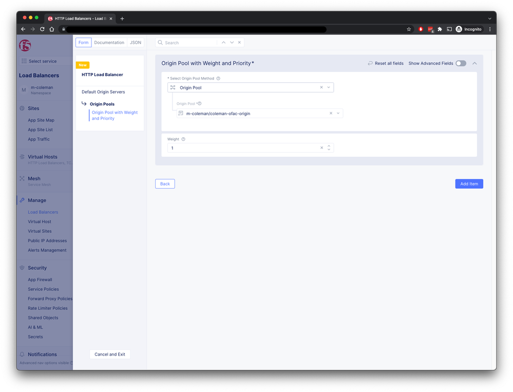

Under Default Origin Servers, click Add Item, and in the Origin Pool drop down, select the pool that was created previously, then click Add Item.
Default Origin Pool
For VIP configuration we will leave as Advertise on Internet.  You will notice under Security Configuration, Service Policies are already set to Apply Namespace Service Policies.  Since I have a few policies in my namespace already, and I want to demonstrate OFAC policies, I am going to change this to Apply Specified Service Policies, and under Apply Specified Service Policies click Configure and select the previously created policy, then click Apply.
Assigning Service Policy
Selecting Created Policy
Save and Exit
From here click Save and Exit.

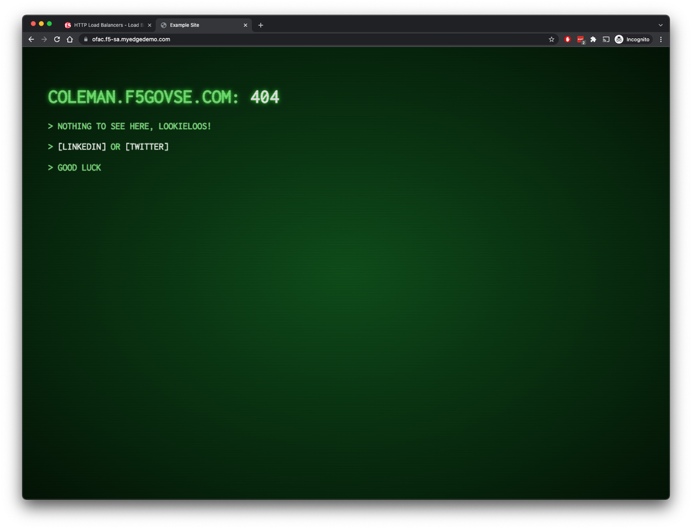

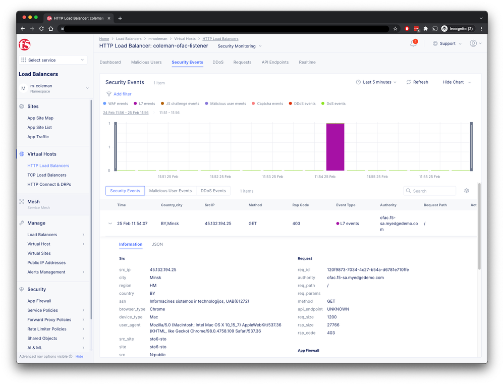

Testing
Using a VPN we can make sure that our policy is up and running.  Since we did not configure a custom response page of any sort we should just get a 403 - Forbidden page.  While users accessing from non OFAC countries will be able to access the application.
Accessing via VPN in sanctioned Country.Accessing from non-Sanctioned Country.
Reporting
We should be able to access the security events now as well, Expand Virtual Hosts, HTTP Load Balancers, and then over the load balancer we created earlier a hyperlink for Security Monitoring will show up, click it.  We can see in the dashboard a L7 security event, and if we select Security Events, we will see that our VPN based request was flagged (l7_policy_sec_event, Rule to match CountryList). If its not totally legible, I VPN'd to Belarus and tried to access the page.
Security Event Dashboard
