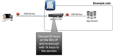

ARCHITECTURAL SOLUTION to support 1024-bit key only applications
If you were thinking about leveraging a virtual network appliance for this purpose, you might want to think about that one again. Early testing of RSA operations using 2048-bit keys on 64-bit commodity hardware shows a capacity in the hundreds of transactions per second. Not tens of thousands, not even thousands, but hundreds. Even if the only use of SSL in your organization is to provide secure web-based access to e-mail, a la Microsoft Web Outlook, this is likely unacceptable. Remember there is rarely a 1:1 relationship between connections and web applications today, and each connection requires the use of those SSL operations, which can drastically impact the capacity in terms of user concurrency.
Perhaps as important is the ability to architect around limitations imposed by applications on the security infrastructure. For example, many legacy applications (Lotus Notes, IIS 5.0) do not support 2048-bit keys. Thus meeting the recommendation to migrate to 2048-bit keys is all but impossible for this class of application. Leveraging the capabilities of an application delivery controller that can support 2048-bit keys, however, allows for the continued support of 1024-bit keys to the application while supporting 2048-bit keys to the client.

BIG-IP is a full proxy-based solution. It can mediate between clients and applications that have disparate requirements, such as may be the case with key sizes. This allows you to use 2048-bit keys but retain the use of 1024-bit keys to web/application servers and other infrastructure solutions.
