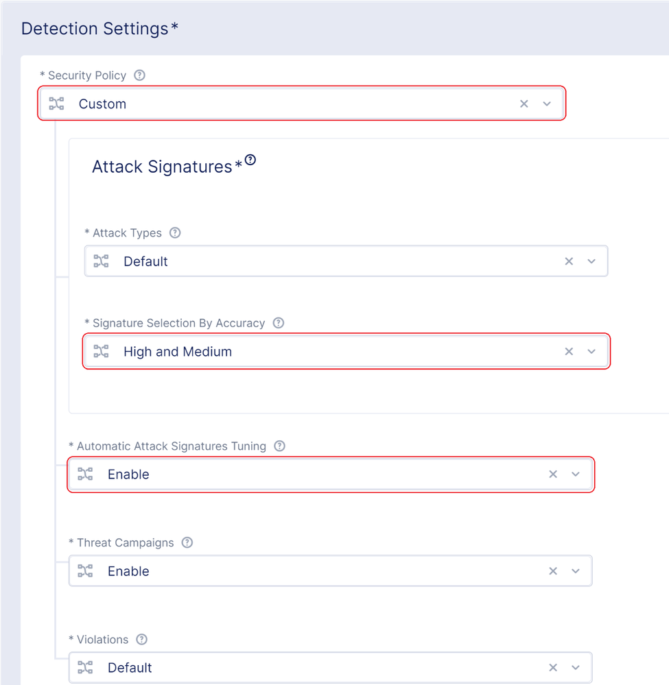

- Navigate to F5 XC Console Home > Load Balancers > Security > App Firewall and click on Add App Firewall
- Enter valid name for Firewall and Navigate to Detection Settings
- Select Security Policy as “Custom” with in the Detection settings and select Automatic Attack Signatures Tuning “Enable” as shown below,
- Select Signature Selection by Accuracy as “High and Medium” from the dropdown.
- Scroll down to the bottom and click on “Save and Exit” button.
Fig 1: Security policy settings to enable Automatic Attack Signature Tuning

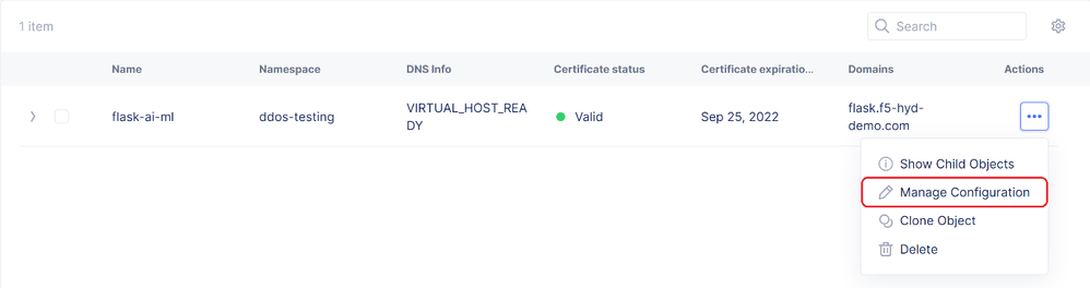

- Click on menu in Actions column of app Load Balancer and click on Manage Configurations as shown below to display load balancer configs.
Fig 2: Selecting menu to manage configurations for load balancer

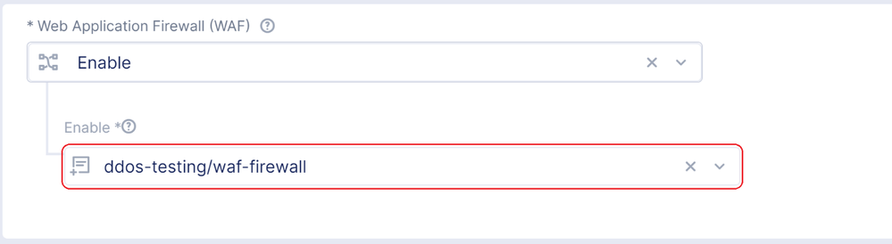

- Once Load Balancer configurations are displayed click on Edit configuration button on the top right of the page.
- Navigate to Security Configuration settings and choose Enable in dropdown of Web Application Firewall (WAF)
- Assign the Firewall to the Load Balancer which is created in step 1 by selecting the name from the Enable dropdown as shown below,
- Scroll down to the bottom and click on “Save and Exit” button, with this Firewall is assigned to Load Balancer.
Fig 3: Assigning firewall to the load balancer

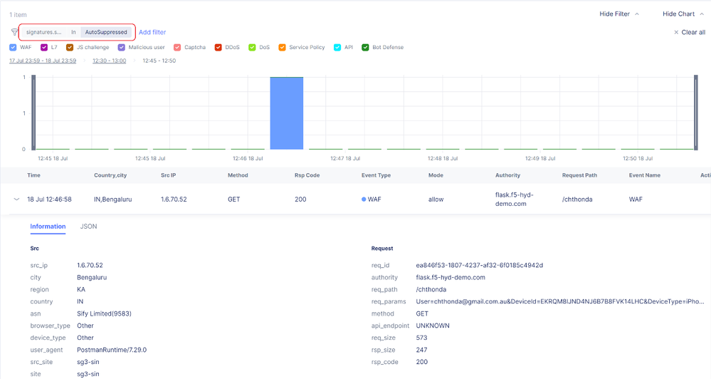

- From the F5 XC Console homepage, Navigate to Web App and API Protection > Apps & APIs > Security and select the Load Balancer
- Select Security Events and click on Add filter
- Enter the key word Signatures.states and select Auto Supressed.
- Displayed logs shows the Signatures that are auto supressed by AI/ML Model.
Fig 4: F5 XC Auto suppress attack signature Abuse of Functionality.
Fig 5: Attack Signature is Auto Suppressed.
