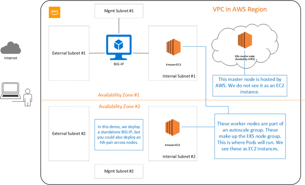

It's fully automated! Since most people are new to Kubernetes (k8s for short), I find myself in need of a quick demo that's totally open for anyone to run. This way after I demo, the audience can go back to run it on their own, decompose it for themselves, and take their own time to understand it all.
Here's what we will automatically deploy:

  1. First, Terraform deployed a VPC and subnets, using the AWS provider.
  2. Then, Terraform deployed some more resources in AWS:
  3. an EKS cluster
  4. an EC2 instance to be the k8s worker node
  5. a BIG-IP VM
  6. Then, Terraform deployed some resources to EKS using the Kubernetes provider:
  7. a k8s deployment using the f5devcentral/helloworld image
  8. a k8s service to expose this deployment
  9. a k8s secret, a service account, and a cluster role binding, all to be used later in the helm deployment
  10. a k8s configMap resource, which is read by CIS and populates a pool in a partition with IP addresses of pods in a given service.
  11. Then, Terraform deployed F5 Container Ingress Services to k8s using the helm provider:
  12. a helm chart that deploys F5 CIS using helm
  13. the helm deployment was configured so that F5 CIS will point at the BIG-IP mgmt address, and use the secret generated earlier.
After all this, the components are all in place. We have an app in k8s that is exposed to ingress traffic, which is routed via the BIG-IP and automatically updated. Our app is protected!
